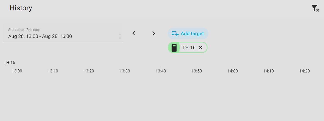

here is my config:
recorder:
  db_url: !secret mariadb_url
  purge_keep_days: 730
  auto_repack: true
I’ve removed any exclude: or include: and also I’ve removed the history:
my expectation is to have everything saved
but:
this device has gone online and offline multiple times in the last day so I would have expected to have “unavailable” and available or things like that.
What am I missing?

It records sensor values, not availability or binary or toggle. How can the database possibly know something is not available, unless you build infrastructure that polls everything and puts it on a heartbeat or something. Items check in when they check in.
Status and availability is an information that could be recorded, is there a way?
In HA I can see when a devices goes unavailable and then back.
In activity I can see:
