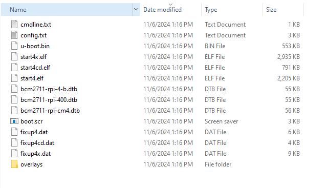

I popped the SD card into my PC and I can’t make heads or tails of the content. Scan disk says the SD card is fine, but I can’t tell if it is what it’s supposed to be and if the backups are anywhere there. I attached a screen shot of the SD card contents.

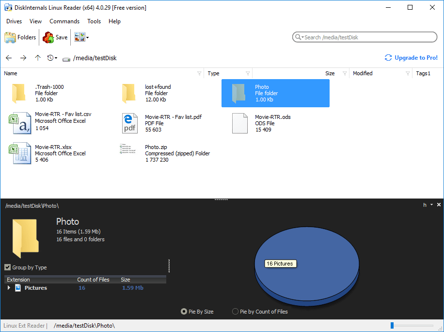

Windows can only read the boot partition of the SD card, it can’t read the Linux partitions. However, install this, and you can read them :
Always good to have one.

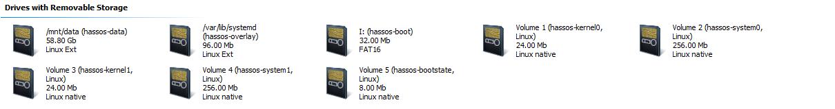

Thanks for the info. I installed it and now see several partitions on the card. Any suggestions on where to go from here?
Backups are on hassos-data. Just double-click and search for your backups

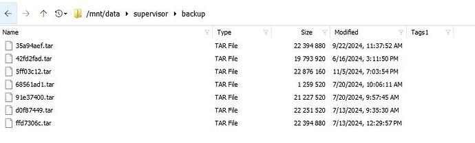

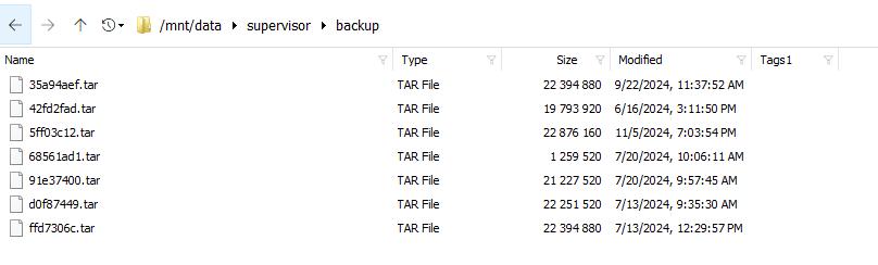

These?
If so, what’s my next step to get a system functional again?

Those timestamps look old (2024).

Thanks for the response! I can’t seem to find any other backups. Unfortunately I can’t browse using the file system, only through DiskInternals so I’m stuck at the partition level. Any ideas where I can find the backups?
Where these backups are. Seems you never set up automatic backups.
