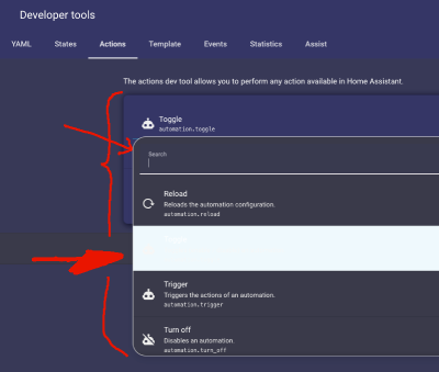

Can somebody please help me?
Got far with my theme edit but now I am stuck.
Hi, searched the forum, reading through advice on theme overviews and tested several things but still dont manage to figure out on how to change this.
I want to change within the Dropdown, select menu in
Developer Tools > Actions
It is not the same setting as input, select menus in cards. Seem to be another section. I am not using dark or light theme (maybee something I should have done but I created the theame to work with both)
The selected item, background, within the menu is white and as I’ve picked white text font. I would change the background or the text on a selected item.
Appresiate any kind of help please.

I did find this with the chrome inpect…
<sup>.combo-box-row.current-value {
    background-color: var(--ha-color-fill-primary-quiet-resting);
}</sup>
I can tick the box and get the white layer to go away…
looking into the html style section
--ha-color-fill-neutral-quiet-resting: var(--ha-color-neutral-95)
Here is where my knowledge ends…
Dont have time to learn this now so guess I’ll be stuck.
Cheers

As for particular cases like that - there are 2 ways: either you will wait for someone’s ready code or try to dig it yourself. The ā€œā€“ha-color-neutral-95ā€ variable is hardcoded in a HA code. Check where & how that ā€œā€“ha-color-fill-neutral-quiet-restingā€ is used; it is probably used somewhere down the hierarchy like ā€œbackground: var(–ha-color-fill-neutral-quiet-resting)ā€ - consider that as setting a variable on a root level to be used on lower levels.
