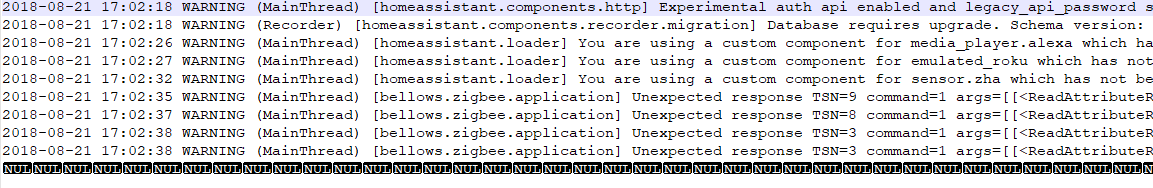

I cannot get into HA now, not sure if it’s actually upgrading, or dead. The Home assistant log basically has a bunch of nuls now. Has not changed at all.
I’ve restarted,
I renamed my db.old, figured it would just make a fresh one, which it does not seem to have done.
Any recommendation, it just seems dead, where to start??
this is my log, has not changed for 20 min. I even tried renaming it hoping that would cause it to create a new log
I’m totally stuck. Running HA on ubuntu 16.04, Python VENV.
I’ve deleted (renamed the home-assistan.log and the v2.db files (three total) they are not being recreated, so I have no logs to look at to help troubleshoot. Is there a non nuclear option?? force 76.2 update to run again?? I have no idea what to do from here,
