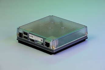

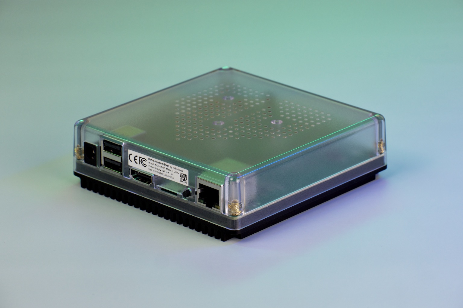

That suggests your running a Home Assistant Green which runs HAOS (Home Assistant Operating System), does it look like this?
If so are there any lights blinking on it? If not check the power supply to it (at the plug). If there are blinking ligths it might be worth unplugging it, waiting a minute, and plugging it back in… then see if the link works.
