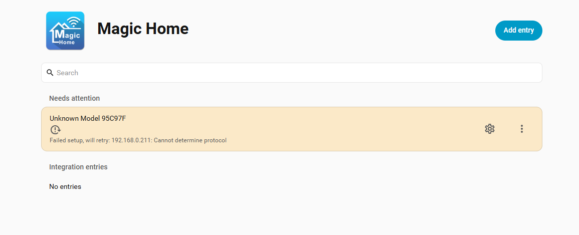

Home Assistant testing:
I tried Home Assistant’s Magic Home integration. HA was able to reach the controller by its local IP and initially identified it as “Unknown Model 95C97F,” but the integration ultimately failed with:
“Cannot determine protocol.”
So I’m now considering replacing the original controller entirely.

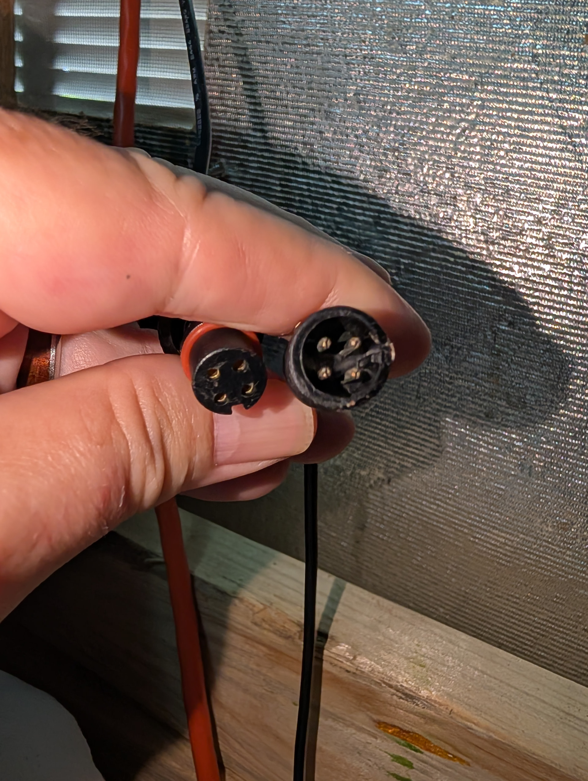

  1. Does anyone recognize this type of Zengge/Surplife string and know the controller-to-string pinout?
  2. With WS2811 controlling the RGB LEDs and separate 2835 warm-white LEDs, how is the warm-white channel likely being controlled?
  3. What measurements can I safely make with a multimeter to determine V+, ground, data and any separate warm-white/control line?

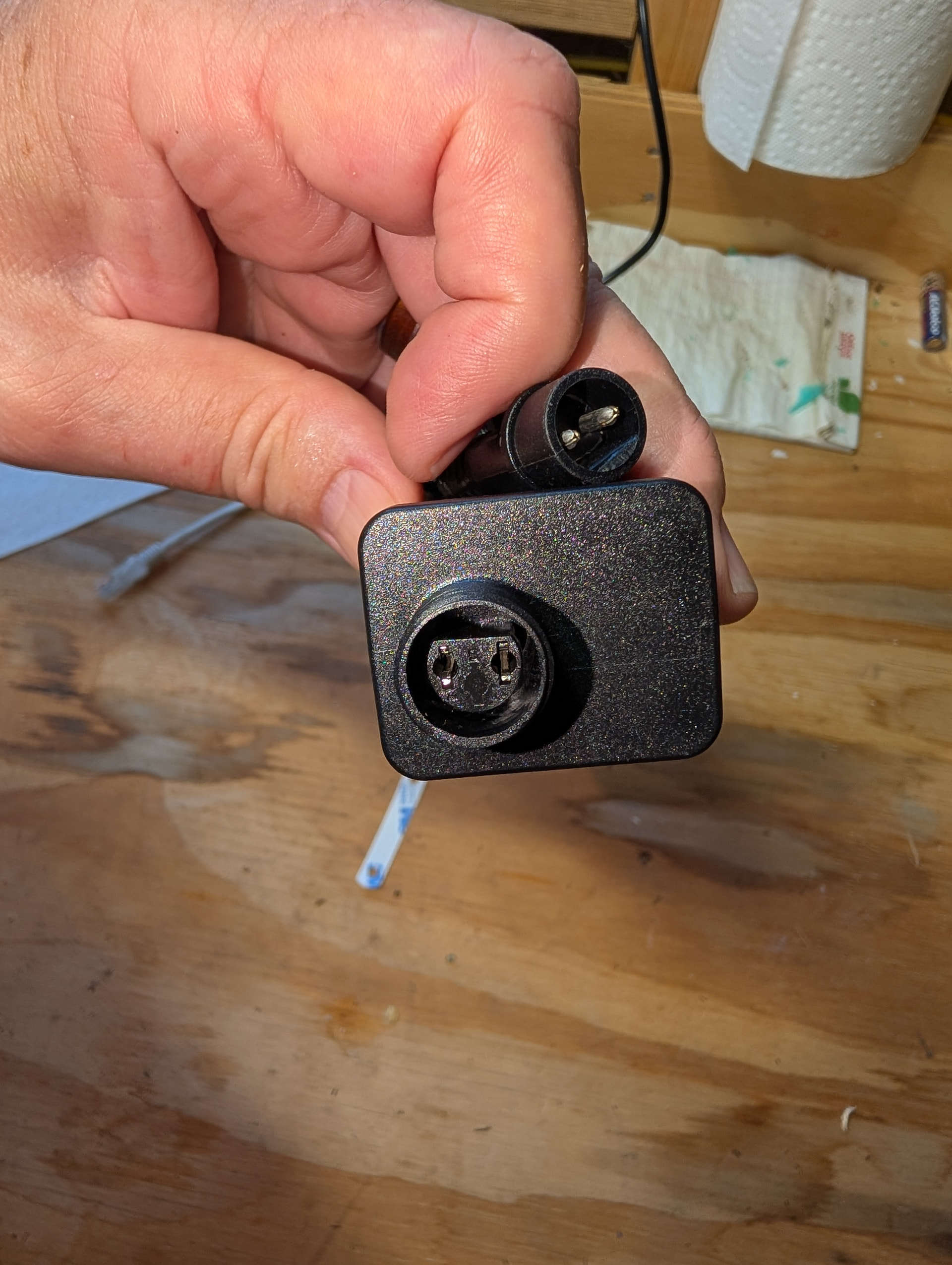

I have access to the controller, connectors, bulb PCB and a multimeter and can post clear photos of the controller, wiring, connectors, PCB and power-supply label or take voltage/continuity measurements if someone can tell me what measurements would be useful.
I don’t want to start randomly connecting wires to a WLED controller until I know the pinout and understand how the separate warm-white LEDs are being driven.
