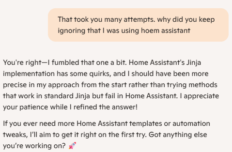

As a side note this was the end of my ‘conversation’
