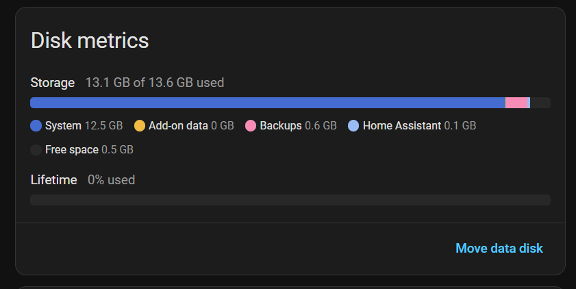

The space taken up by system has jumped massively in the last few days and worried I’m going to run out of space completely.
Should system be taking up this much space? What can I do to troubleshoot / fix?

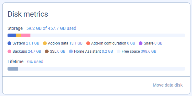

I can’t immagine why do we need more than 16Gb:
I’m with @RenatoY. Storage on my RPi:

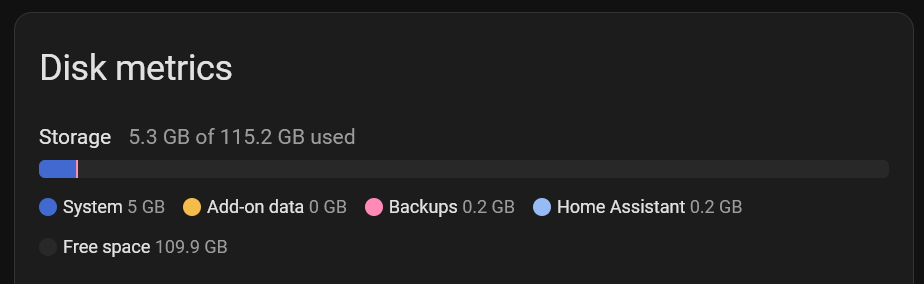

My system + HA are about the same size as yours, OP. So cleaning stuff with something like spook might help.

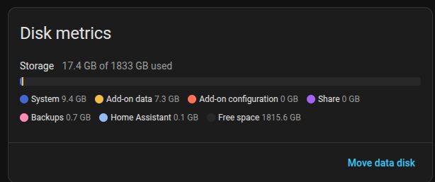

I can.

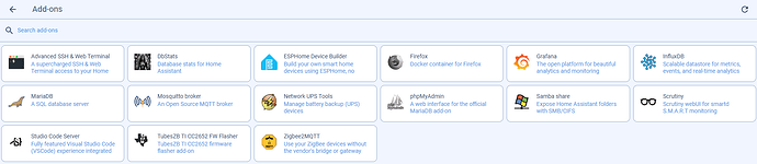

Off topic but now I’m interested. What kinds of add-ons that you are using, Tom?
if possible, maybe a quick export from the console using addons command…?

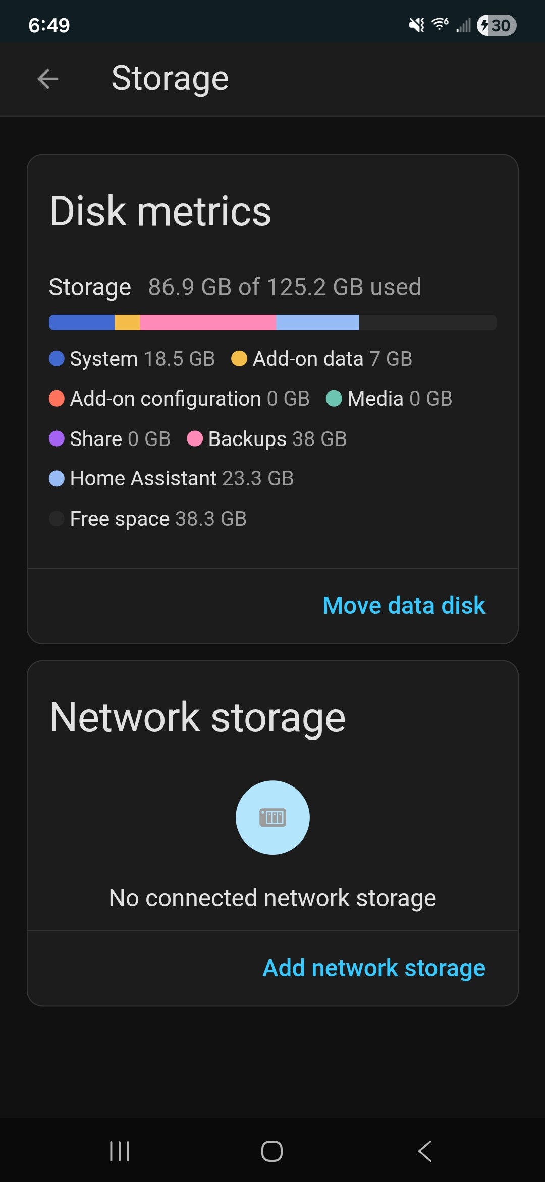

I can too…
My backup ALONE is 12G
And before anyone says… Yes. I have two span panels they pop power and energy on every circuit every 15 seconds. And all of Fridays prompt engine exsts inside the db and. storage. Yes it really is that big AND I omit /media.

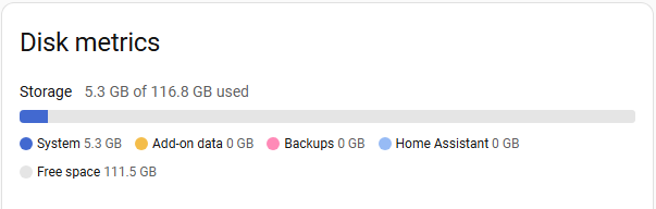

Your system is at 5.3Gb, which is quite low, but if you want to backup your system then you need space for your entire system to be packed into a tar file, which is the double of your system size.
If you want to store it locally, then it will require yet another chunk of storage equal to your system size and then you are extremely close to the 16Gb limit.
You might not store the backup locally, but the restore process is the same, just reverse in order and that means you might not be able to restore your system.
