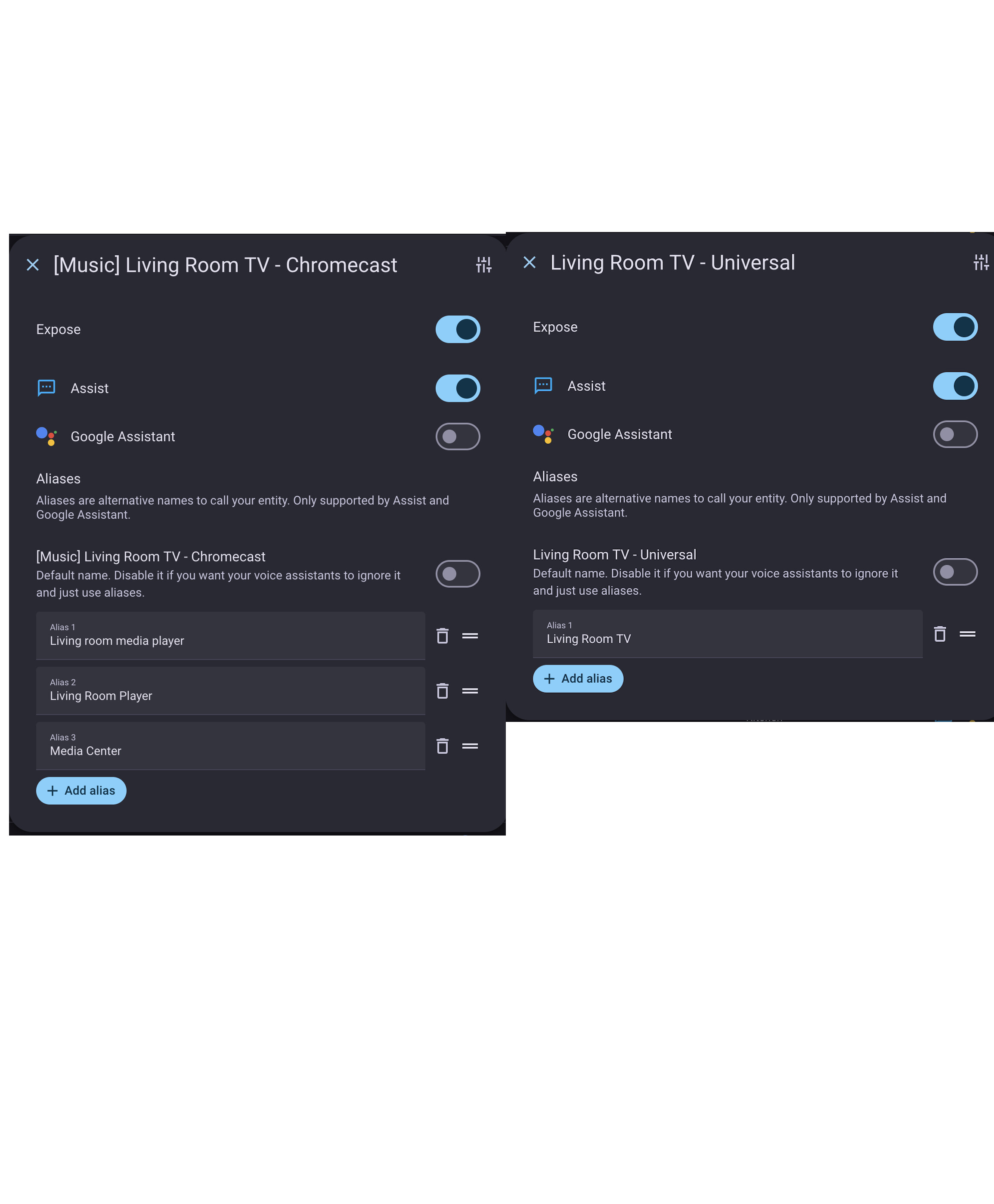

I wanted to do this without exposing all the entities mentioned above, so I figured I’d only expose the Universal Media Player and that should take care of everything, however it doesn’t seem to work properly. It manages to turn on and off the TV like I want to, but it can’t seem to be able to play music. So I also exposed the Music Assistant entity (See attached pictures for how these entities were exposed). Which kind of works, but not exactly the way I want it to. Now in order to get what I want I have to give the following commands:
  • ‘Turn on the Living Room TV’ - This works fine using the universal media player
  • ‘Play [Artist] on the Media Center’ - This works using the Music Assistant entity.
The problem I have with this is that I expose two different entities with two different aliases/names which I have to use in order to control one device - the TV. Is there any way to be able to do this the way I am trying to? I tried modifying the universal media player to route the media_play, play_media, 'media_browse, media_search`, etc. commands to the MA entity like so:
