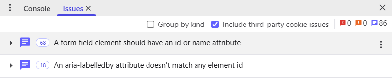

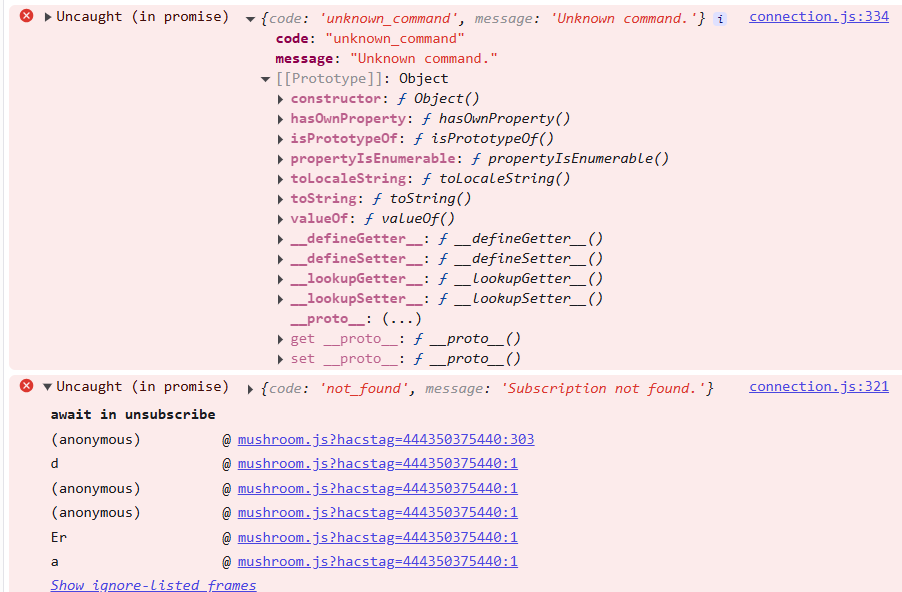

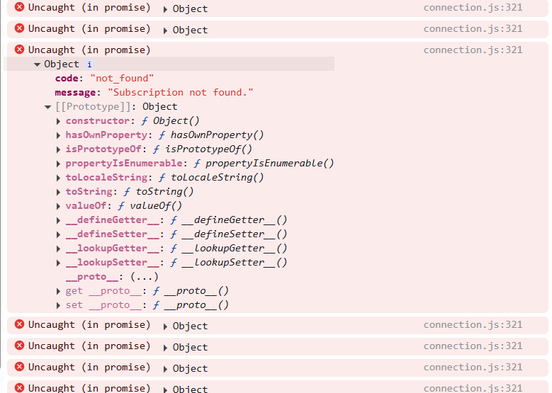

Honestly have no idea what’s going on here but have so many errors, lots of these connection.js:321 Uncaught errors and also these form field element and aria-labelledby errors I’ve never even seen before, don’t know where to start…
Dashboard loads and works correctly both on mobile app and web browser, when trying to edit the page on a web browser it refreshes multiple times before I can edit it but that’s also new…
Haven’t changed anything fundamental that I can think of that would cause this, hope someone can help me troubleshoot this…
error1

Hmm, mushroom related? But I haven’t changed anything relating to mushroom that I recall…
So where are all these screenshots coming from? At first glance I wasn’t even sure they were HA.
Dev tools (F12) in a browser
Looks like your issue is with the mushroom card. Start removing them until the error goes away (paste them into a text editor so you have a copy to replace later).

My main card that has my home assistant frontend based upon was a standard masonry layout card as it has been for years, this card gave me hundreds of these errors (its a very large card with many mushroom elements)
I just tried recreating the card but this time using the sections layout and zero errors! I have completely copy/pasted over the config from masonry layout to sections layout and it works flawlessly!..
It’s not a Mushroom related issue from what I see in DevTools. The issue appears to be isolated to the Masonry view across multiple card types and with or without HACs installed. The errors appear to occur after
