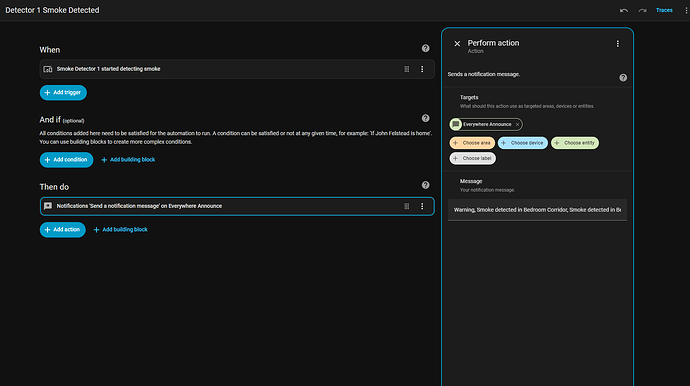

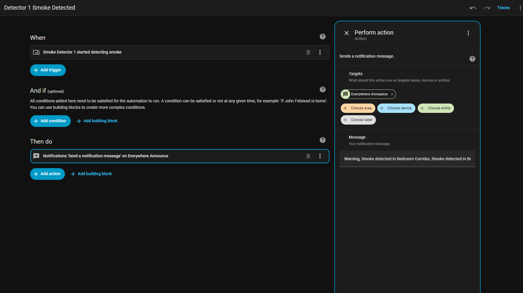

However I have created the following automation as per attached screenshots:-
- Trigger
a) Device Trigger
b) Device Trigger State “Smoke Detector 1 started detecting smoke”
c) Duration 01 second
- Action
a) Send a notification message
b) Entity- Announce everywhere
c) Message- “Warning, Warning, Smoke detected in bedroom corridor”
I have tested the action and the announcement plays on all of the echo devices.
Is there anything else I should do? I don’t appear to have used any of the advanced markup found in the Alexa Devices docs but perhaps what I have done above is written to the automations.yaml??

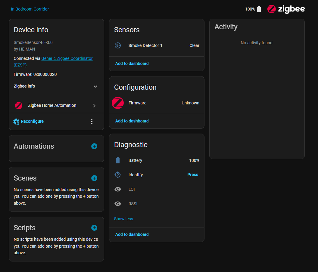

For further info the Heiman Zigbee Smoke detector screenshots are added below
If you need further info please let me know and thanks again.

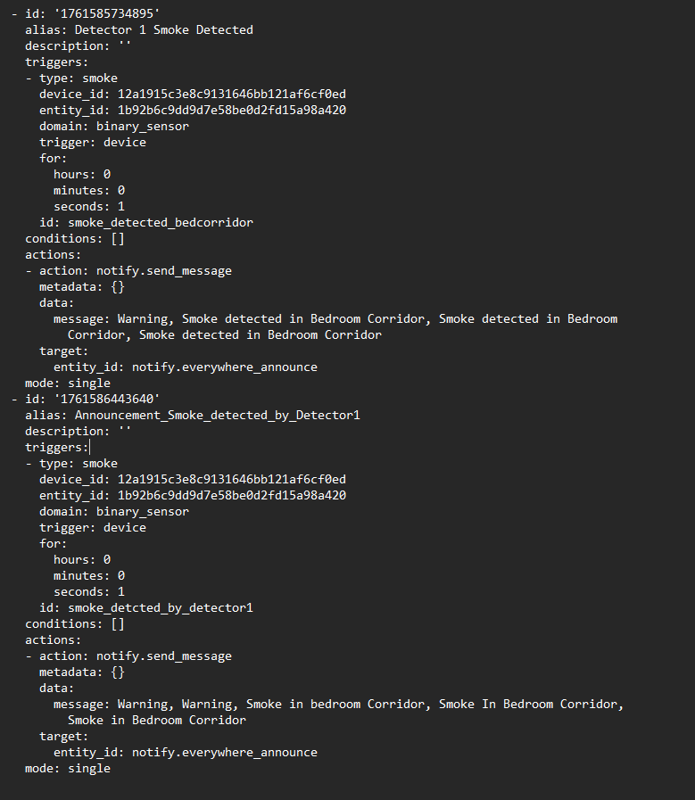

What you have shared looks fine, though it would be easier to spot any issues if you would share the YAML configuration instead of screenshots.
If the automations are in automations.yaml you should be fine. You may want to go to the Automations tab and refresh your browser cache and see if they reappear. Automations are also entities, so you can check the Entities list to see if they are there… there should be a link to edit them in the entity settings popup that appears when you click on them from that list.
The “advanced markup” (aka SSML) is optional.
There you go ![]()
