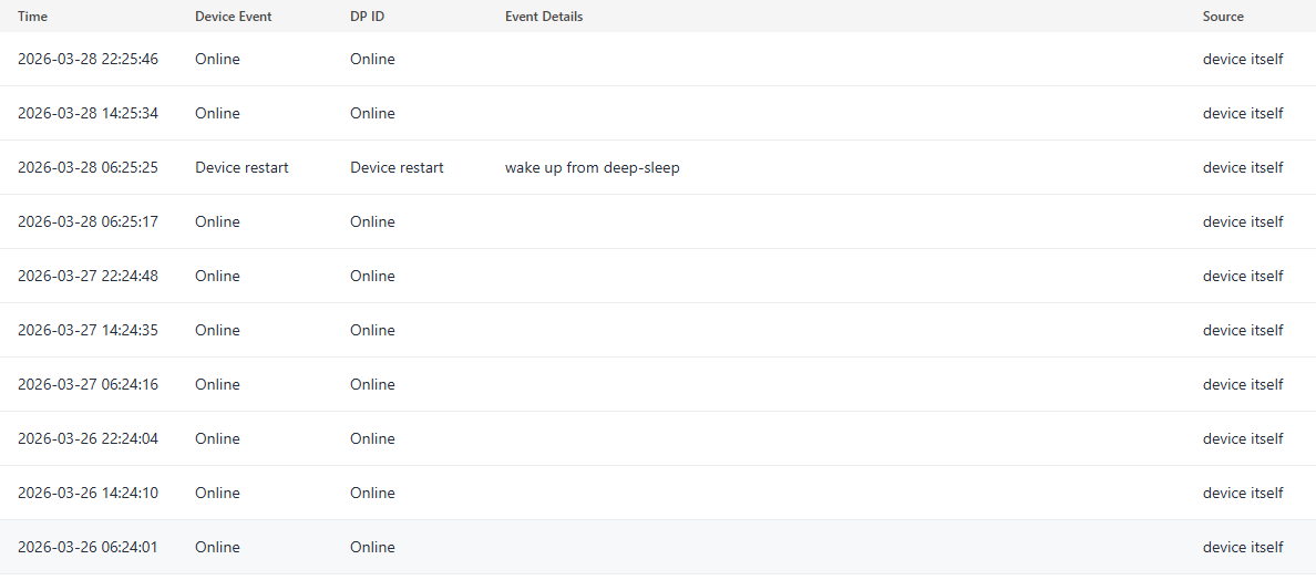

I have a Tuya Wireless 2 Gang Smart Scene Switch (aka Tuya Wireless Switch). ID eb404e0ebdc96783a7ptu7, category wxkg. It consistently sends press events even though I haven’t pressed it. I’ve been logging these events for a few days now and the comparison of the Home Assistant press logs and the Tuya Developer Portal logs are interesting.
Tuya Logs
Home Assistant ‘Logs’
21-03-2026-08-36-15, 22-03-2026-00-36-44, 22-03-2026-16-37-04, 23-03-2026-08-41-52, 24-03-2026-03-23-25, 24-03-2026-19-23-29, 25-03-2026-11-23-33, 26-03-2026-03-23-54, 26-03-2026-19-24-10, 27-03-2026-11-24-17, 28-03-2026-11-25-17, 29-03-2026-03-25-46‎
The core Tuya integration appears to be using heartbeat messages as press/click events.
My automation only captures press/click events, so it’s definitely not using a different event_type for heartbeats.

Additional information
Each event is also duplicated.
I’ve filtered this out of my automation by checking how recent the last log was.

Though officially this would classify as a bug in the integration creating the event entities, my opinion is that this is also in part caused by a very badly designed event entity.
But it is the integration you should report the bug to, as they should not trigger a state change for anything other than presses or changes in availability.
It’s the core Tuya integration, yeah. In the issue I linked to the integration & it’s documentation as the template instructed.
Yeah, this looks like a Tuya issue, not your setup. The switch is basically sending heartbeat updates, and Home Assistant is treating them like button presses. Since there’s no separate event type, it can’t really tell the difference. Best workaround is to filter by timing, gnore events that happen in a pattern or too far apart from a real press. Otherwise, you’d need a fix in the Tuya integration or switch to something local like Zigbee if possible.
