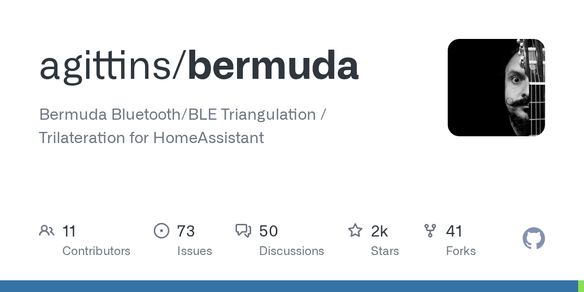

I think what you are looking for is the Bermuda integration to track room presence.
It also has device trackers for home / not home. The last one can be done without Bermuda too, but Bermuda is so much more powerful. If you want to keep it simple you can edit known_devices.yaml, but that file is deprecated and it is harder to do right.
As you mentioned many BLE devices change MAC to avoid tracking (e.g. phones, but more expensive trackers too.) For those you can use the private BLE integration. It combines well with Bermuda too.
