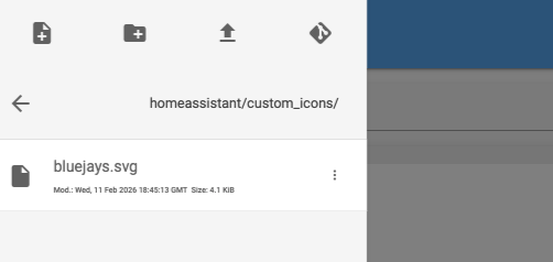

I’ve uploaded the file to the /homeassistant/custom_icons/ path as shown below:

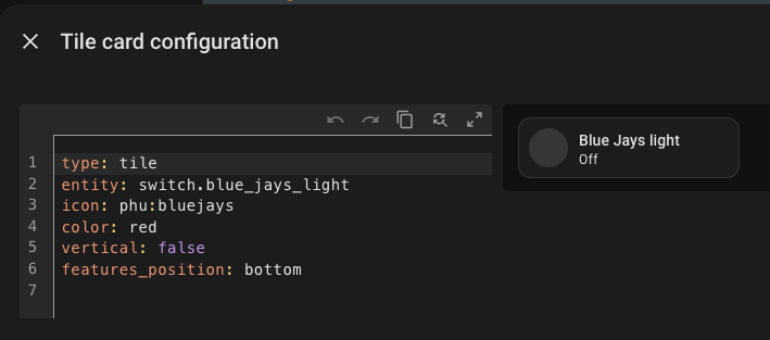

I’ve restarted HA, reloaded the front end a few times, yet the icon doesn’t turn up correctly as shown here:
Not 100% what I’m doing wrong here, but GPT tends to think everything is correct in terms of path within HAOS, so likely an issue with the SVG rendering?

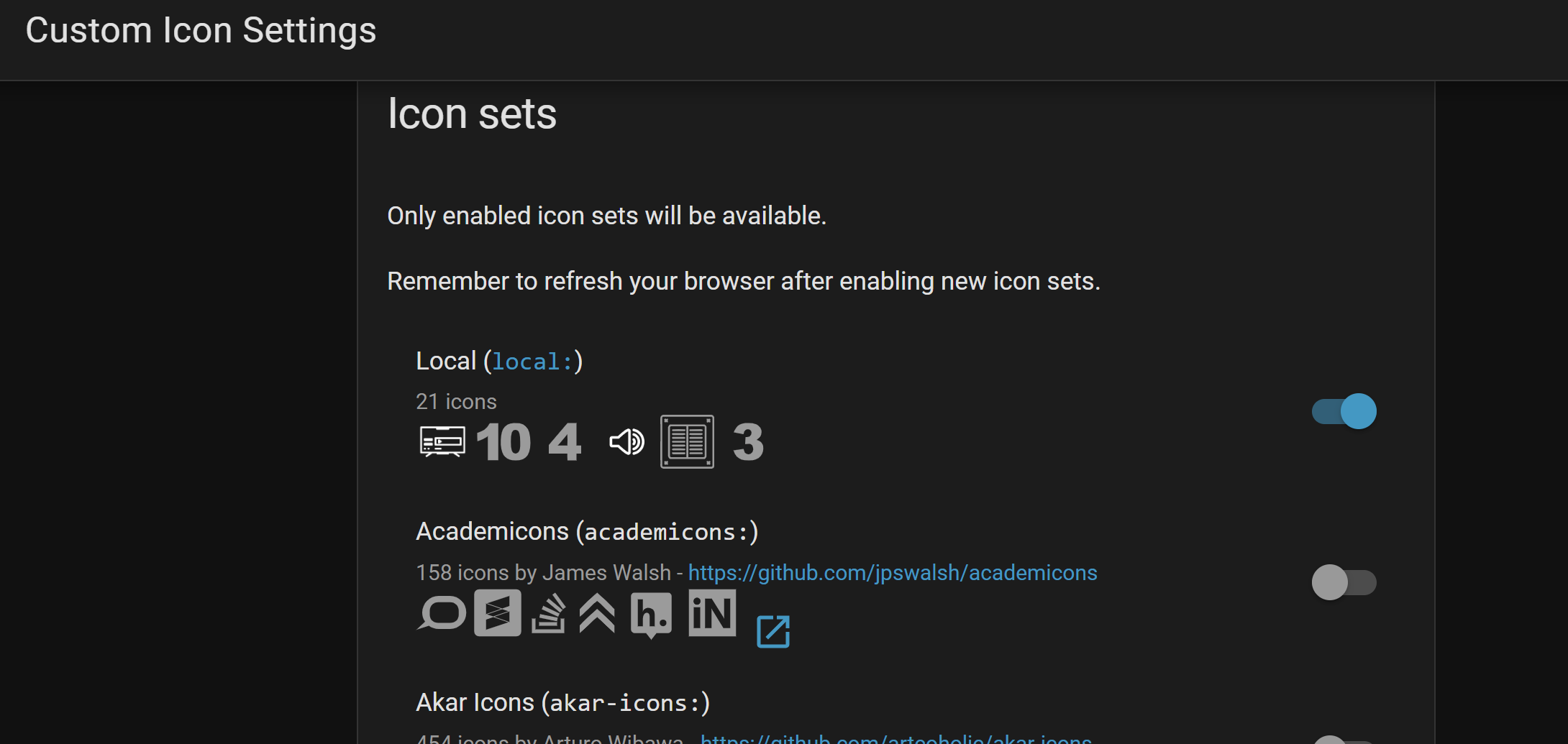

If you’re using the following Custom Icons card found in HACS then you need to enable Local Icons in the integration and use the prefix local: not phu:.

As you may have guessed I have both integrations installed (custom brand icons and custom icons) and the LLM confused the phu: prefix used in the former, and what I should’ve actually have been using (local:) in the latter that @almighty59 correctly pointed out.
After an adjustment in my YAML, and a reload, everything is working just fine. Thanks for the reality check!
