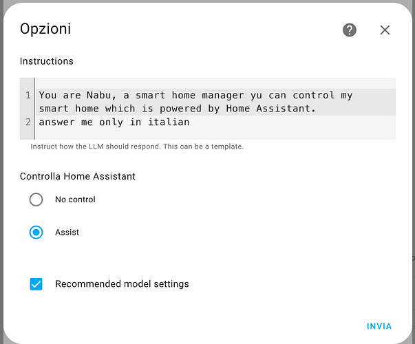

I’m running Gemini 1.5 Flash Latest using those prompt
But I’m sure that there is a better way to tell him. I whatched akready on google cloud console but with no result trying other configuration.

So even if he say Okay, spengo il televisore in soggiorno ( ok i turn off the tv) the action is not done!
Is it a way to set good prompt to make the agent interact correctly with the house? in the prompt command of the agent i tryed to change parameters but with no result
