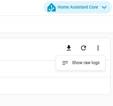

Via Settings > System > Logs
Then select “Show raw logs” in the upper right corner (Default Home Assistant Core is the one you mostly want).
