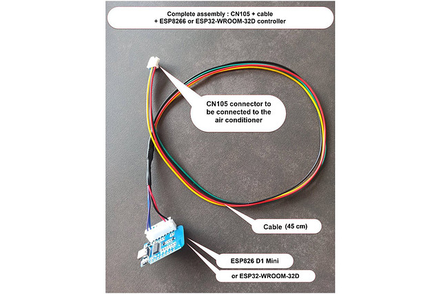

So, what should i buy? I read about ESPHome, but am still not exactly sure what that is? And from my best research the "CN105-2HA controller" seems an easy device to instal inside the airco, but would it be a good buy?

Yes the controller cable with the ESP32 attached to it is the best option for your case to control each one once setup and linked to HA, the other option is to setup an IR blaster and just program the controls to be sent that way.

It's a bit expensive for a basic esp board, a cable & some pre-flashed (free software). For the same price as 1 unit, you could get a bundle of 5 esp mini boards & another bundle 10 CN105 cables from Aliexpress, solder on the cables & flash the software yourself.
There's only 4 wires to solder & it looks like a straightforward enough starting project, plus you'll have spares in case you mess something up.
That is an ESP dev-board directly plugged into the AC. I would be hesistant to run that 24/7.
…in a 5v circuit.
There, fixed that for you.
Hundreds (possibly thousands) of people have done the same thing for years with no issues. Just look at the Midea thread to get an idea of the scale. It’s simply plugging in an ESP 32 on a 5v rail - no different than powering it over usb.
For anyone US based, I wrote up a guide to DIY your own ESP32 CN105 thermostat controller for Mitsubishi mini splits CN105-to-Grove Cable and ESP32 Parts List | Serin Labs There, you’ll also see that I sell a premade cable or a kit with the controller and cable. It can be flashed with ESPHome firmware through a browser using the flasher.
