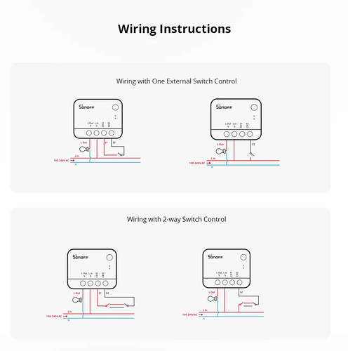

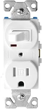

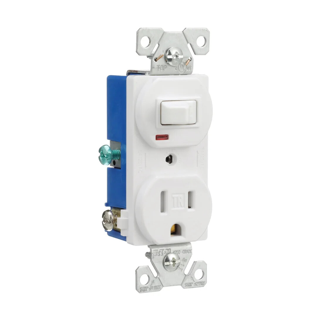

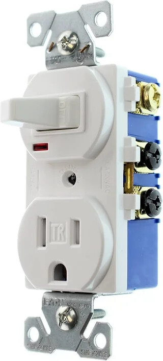

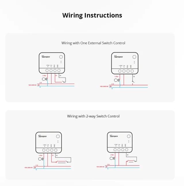

I am trying to add a ZBMini-L2 to a combo switch (pictured) that controls a floodlight. I can control the relay using Home Assistant, but the relay does not detect when the switch is toggled. The switched live wire (from the brass screw, third picture) is connected to S2 on the relay as shown in Sonoff’s wiring diagram (upper-right scenario in the fourth picture).
