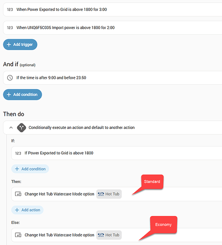

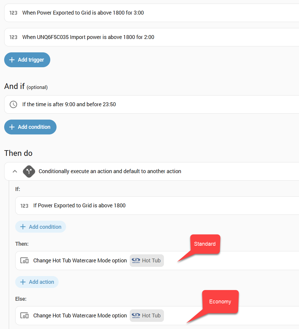

So I’ve created an automation like this: (You can’t see the mode change in my screen grab so I’ve added captions)
(more below)
By my reckoning, it’ll trigger if I’m exporting over 1800w for 3 mins, OR, importing more than 1800W for 2 mins, THEN, it’ll EITHER turn on standard mode (heating) IF Export is STILL over 1800W, othewise it’ll switch back to Economy mode.
And it’ll only operate between 9am and 23:50 (as I always want it on Eco mode from midnight till 9am as I have a super cheap tarrif then. - Eco mode actually tells the hot tub (internally) to never heat outside of 00:00 to 06:00.). Standard mode tells it to heat when it wants.
The only catch with all of this is now, during the day, if I have something like the oven on, but I want to manually heat the tub some more, the automation will trigger and keep turning off the heating as it’ll see a big power import.
I almost thing I want two automations - One that sees export power wastage and turns on the tub, and a seperate one that only runs once the first one has been triggered.
I think I’m talking myself round in circles :slight_smile:
