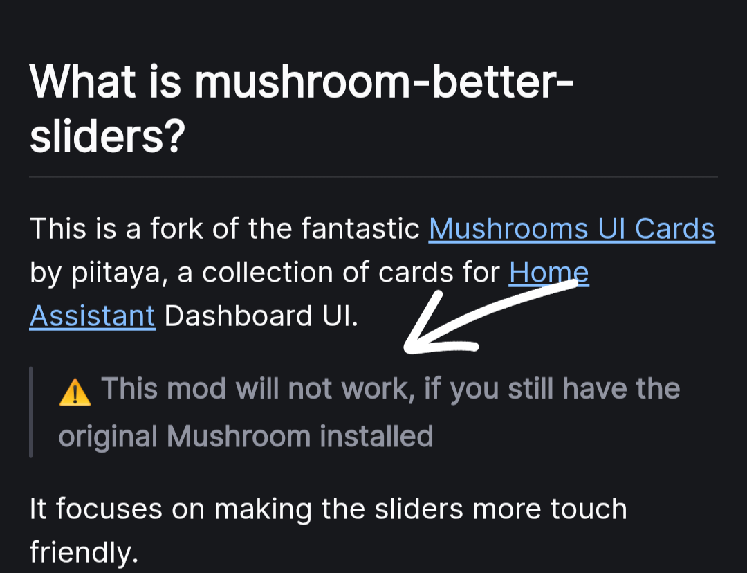

Uncaught error from Chrome 137.0.0.0 on Windows 10 Error: Failed to execute ‘define’ on ‘CustomElementRegistry’: the name “focus-trap” has already been used with this registry A.define (src/scoped-custom-element-registry.ts:180:12) /hacsfiles/advanced-camera-card/card-855fd26e.js:75:3686
Uncaught error from WebKit 605.1.15 on iOS 18.5 Error: Failed to execute ‘define’ on ‘CustomElementRegistry’: the name “mushroom-select” has already been used with this registry message (node_modules/core-js/modules/web.dom-exception.stack.js:26:24) src/scoped-custom-element-registry.ts:181:8 /hacsfiles/lovelace-mushroom-better-sliders/mushroom.js:29:67 n (/hacsfiles/lovelace-mushroom-better-sliders/mushroom.js:1:964) module code (/hacsfiles/lovelace-mushroom-better-sliders/mushroom.js:569:67)
Uncaught error from WebKit 605.1.15 on iOS 18.5 Error: Failed to execute ‘define’ on ‘CustomElementRegistry’: the name “focus-trap” has already been used with this registry message (node_modules/core-js/modules/web.dom-exception.stack.js:26:24) src/scoped-custom-element-registry.ts:181:8 module code (/hacsfiles/advanced-camera-card/card-855fd26e.js:75:3692)
Uncaught error from Edge 137.0.0.0 on Windows 10 Error: Failed to execute ‘define’ on ‘CustomElementRegistry’: the name “mushroom-select” has already been used with this registry A.define (src/scoped-custom-element-registry.ts:180:12) /hacsfiles/lovelace-mushroom-better-sliders/mushroom.js:29:61 /hacsfiles/lovelace-mushroom-better-sliders/mushroom.js:29:76 n (/hacsfiles/lovelace-mushroom-better-sliders/mushroom.js:1:963) /hacsfiles/lovelace-mushroom-better-sliders/mushroom.js:569:66
Uncaught error from Chrome 137.0.0.0 on Windows 10 Error: Failed to execute ‘define’ on ‘CustomElementRegistry’: the name “mushroom-select” has already been used with this registry A.define (src/scoped-custom-element-registry.ts:180:12) /hacsfiles/lovelace-mushroom/mushroom.js:23:126 Kr (/hacsfiles/lovelace-mushroom/mushroom.js:1:15090) /hacsfiles/lovelace-mushroom/mushroom.js:286:46391

i believe the 137.0.0.0 is the Chrome version
