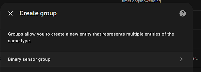

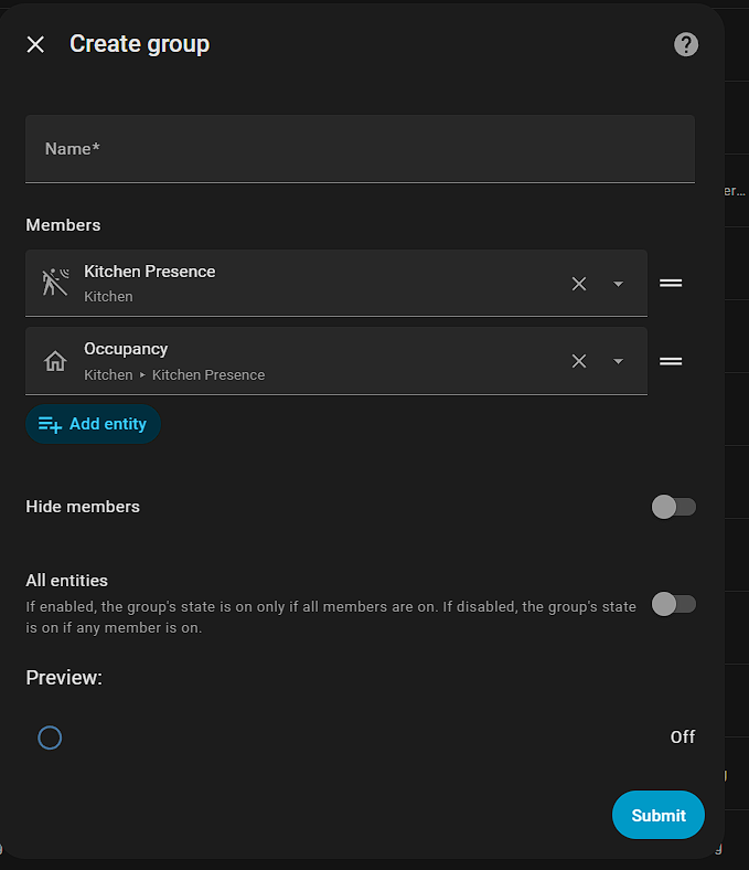

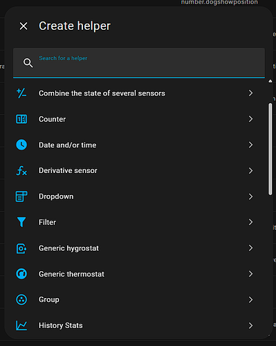

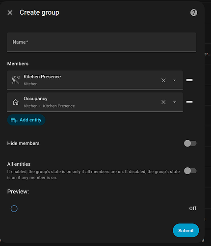

For these I have utilized “groups”
Create a helper from your two binary sensors.
Then you can have that group sensor turn on and off based upon the group.

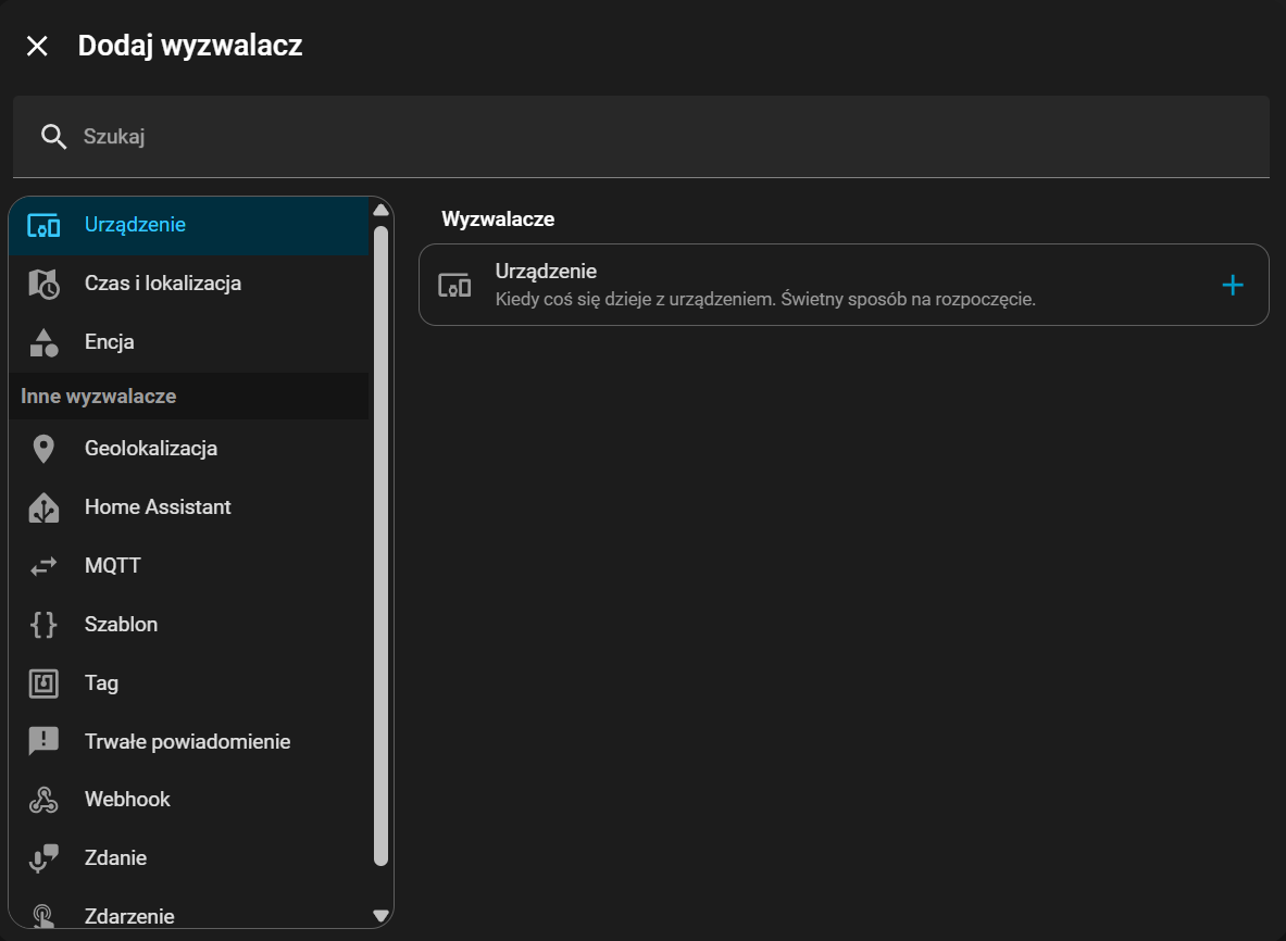

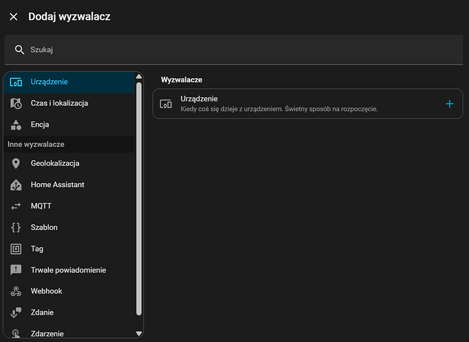

I created a group, but I dont see how to add it whe ncreating an automation.
Just add it as a state trigger, example:
