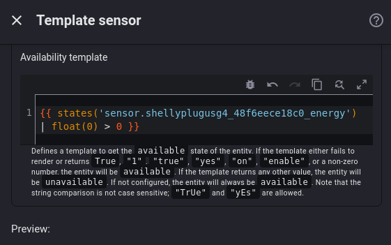

Templating Rule #1
Scratch that, just saw the note…
In the UI, you don’t keep the availability:… make sure it looks like the following in the Helper config flow:

edit: THANKS that worked, those element tags always throw me off weather they are needed in the UI or not from case to case
One other thing… The template you pasted is using “pretty” quotes in the states function. These are often picked up from copy/pasting from improperly formatted text.
Make sure you use normal/plain quotes.
#These are pretty quotes
{{ states(‘sensor.shellyplugusg4_48f6eece18c0_energy’) | float(0) > 0 }}
#These are plain quotes
{{ states('sensor.shellyplugusg4_48f6eece18c0_energy') | float(0) > 0 }}
not sure when or how they end up fancy quotes, but i always re-type the quotes manually when pasting them into HA to avoid the quote disaster
They usually creep in when copying unformatted text from the forum.
