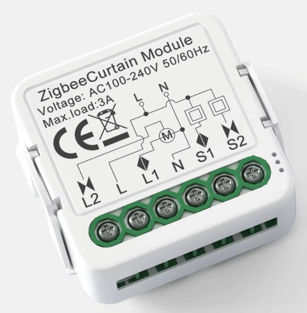

I've installed the TZ3210 TS130F ZIGBEE switches on all my 12 motors. Naïvely thought it'd be no problem once connected to HA i also covered them up behind their boarding and didn't build switches apart from two rooms... (yeh big mistake)
They are paired fine but i cannot for the life of me figure out how to actually calibrate them. Tried it all and been looking all for a good week now. Their End spots are never correct and the HA menu isn't very helpfull in that regard.

I have these
I tried it, with the one i have on my desk but doesnt seem to respond on the button presses.

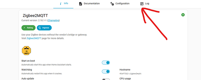

Sorry, i do not know where to pull logs from.
Settings --> Apps --> Zigbee2MQTT

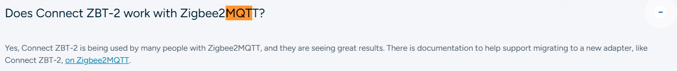

Thanks for the quick response. The problem is however i bought the official HA ZBT 2 Dongles (one for Thread, one Zigbee) , Zigbee2MQTT doesnt work with them and from what i've read last night it is very inadvisable to run multiple zigbee networks.
There's no issue running Z2M with A ZBT-2. If you have two, running ZHA on the other one,set up the second one with Z2M and pair the devices - it's quick to see if you can calibrate there or not. I'm not suggesting you run two different zigbee networks in the future, just to test.
Cheers Fleskefjes. i will try that tonight when i get home from work.
CoPilot and ChatGPT straight up told me it Z2M doesn't work with ZBT 2 and to buy another adapter :face_with_bags_under_eyes:
https://www.home-assistant.io/connect/zbt-2:
Even says on the website.
