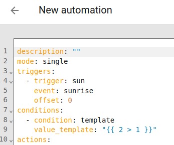

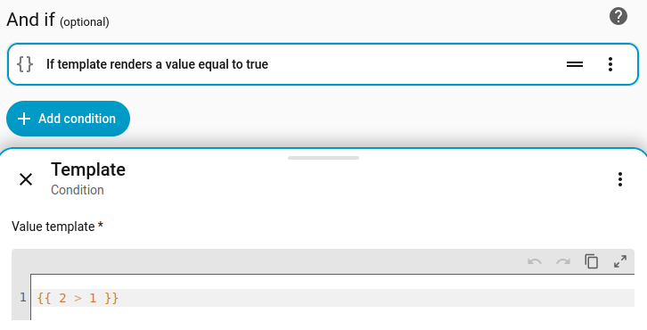

Thanks both. I see the extra quotes, but I cannot figure out how to remove them. I set up the automation in the GUI using “Conditionally execute an action and default to another action” and then “If template renders a value equal to true”, and it added the double quotes and single quotes automatically. When I edit to remove the quotes and resave, they reappear. Any suggestions?
I just used the Automation Editor, in Visual Mode, to create a Template Condition and it did not add double and single quotes automatically. It wrapped my template in double quotes only.
Visual mode
YAML Mode

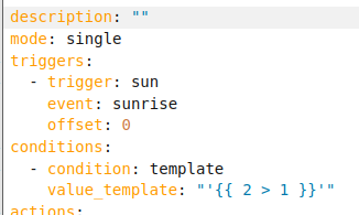

NOTE
Don’t do this (explicitly wrap it in single-quotes):
Because then you will get this (wrapped in two sets of quotes):
Thanks. When I look at the automation configuration (under automation - traces - automation configuration (which is where I copied from in my first post)), it shows the combination single and double quotes. But when I choose “edit in yaml”, only the double quotes show up. So now I am not sure what is going on.
In the UI you should not add any quotes to the templates.
