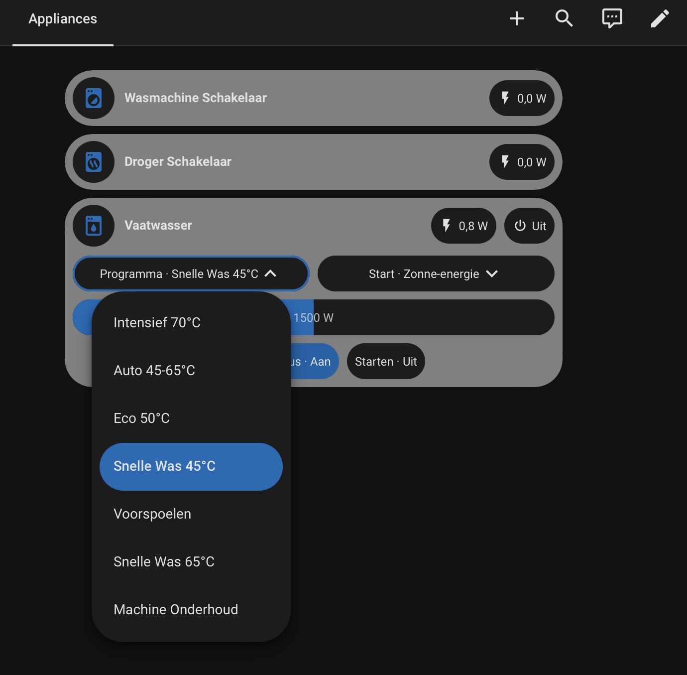

Attached a picture of the UI I made where I can pre-select the washing program. This is the dishwasher program entity. I select the desired program before switching on the dishwasher.
I have made two start options, the dishwasher can be started: one is manually and second by sun energy excess power. I made a slider where I pre define the level of excess power the dishwasher has to automatically start its program without further manual.intervention. Somehow I have to remember the program entity state before powering on and use this to override the default ECO mode when powered on.

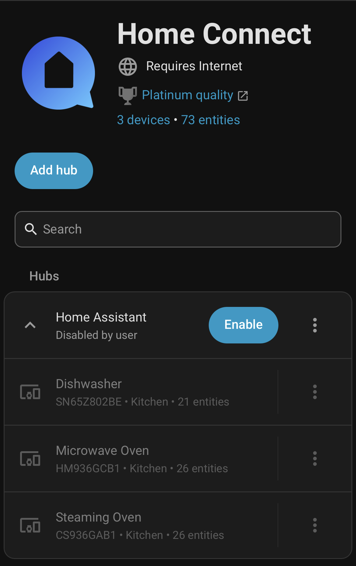

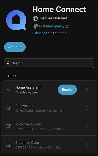

Another option is to disable only the device (which i did earlier, as i had some issues with my ovens).
So the dishwasher was running local, and the ovens not ![]()

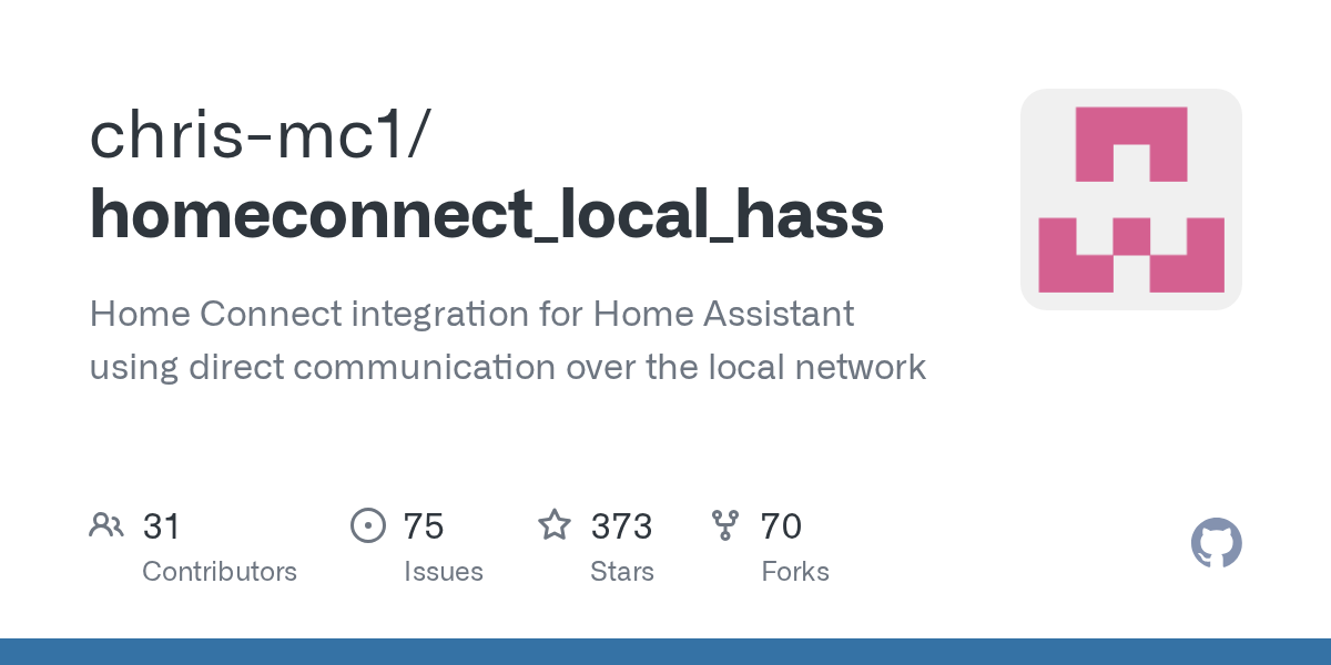

read the pre-requisite here —> GitHub - chris-mc1/homeconnect_local_hass: Home Connect integration for Home Assistant using direct communication over the local network · GitHub
- Use the Home Connect Profile Downloaderto download your Appliance profiles, select "openHAB" as target. The downloaded ZIP-file contains each Appliance encryption Key and feature descriptions

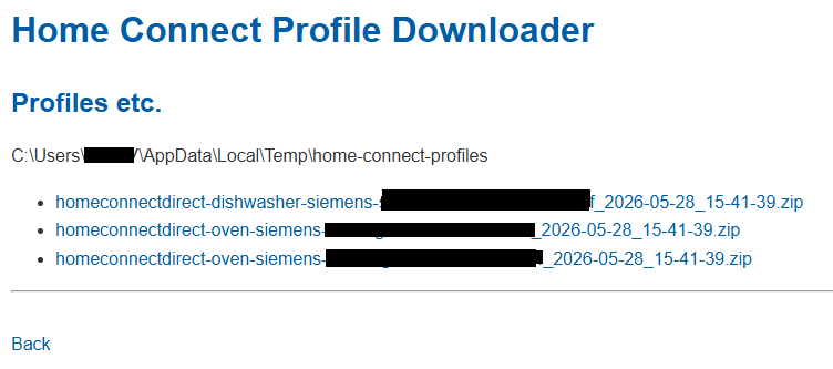

No, it downloads your equipment profile(s) from the Home-Connect site.
- Visit Release 1.0.2 · bruestel/homeconnect-profile-downloader · GitHub and download your software (for windows, use homeconnect-profile-downloader-win32-x64-1.0.2.zip)
- Unzip it, and run homeconnect-profile-downloader.exe
- Select your location, set target to 'openHAB' and hit 'Fetch Application Data'
- Find your downloaded files in c:\users<username>\appdata\Local\Temp\home-connect-profiles
These zip files are the profile files required to complete the setup of the integration.

Hi acindy, thank you so much for the information, especially the link to the Home Connect download tool. This was the missing piece in the puzzle.
I succeeded to download my dishwasher profile and have this imported into Home Connect Local. The integration could not find my dishwasher but after using the ip address it was oke.
