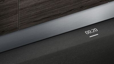

While idle, it will project the timer on the floor, something like this

My dishwasher then projects the starting delay on the floor and starts washing at the set time.
