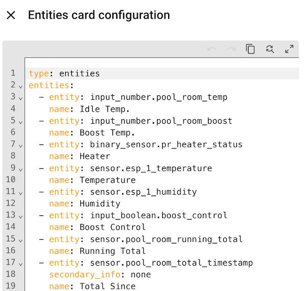

Hi all,
is there something I could do in here…
To make this…
Read like “Total Since 31-03-2026 at 12:20”

You need to create a template sensor with this template:
{{ states('sensor.pool_room_tomtal_timestamp') | timestamp_custom("%d-%m-%Y at %H:%I")}}
If the state actually is a timestamp.
Thanks
I tried a template with that code(spelling mistake corrected) but get an error in the template editor and ‘unavailable’ in the front-end…
ValueError: Template error: timestamp_custom got invalid input ‘2026-03-31T12:16:23.497000+00:00’ when rendering template ‘{{ states(‘sensor.pool_room_total_timestamp’) | timestamp_custom(“%d-%m-%Y at %H:%I”)}}’ but no default was specified
Any ideas - i’ve not used templates before
Found it - this works perfectly, thanks
{{as_local(as_datetime(states('sensor.pool_room_total_timestamp'))).strftime('%d-%m-%Y at %H:%M') }}
