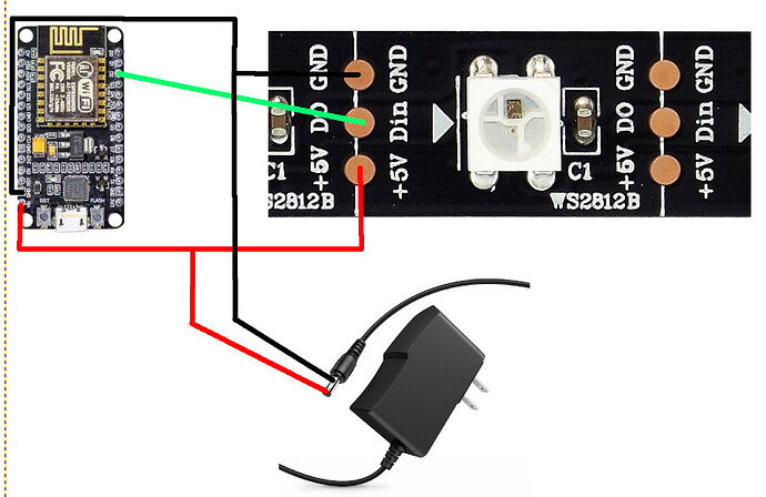

Which one, do you have a picture?
I am using this setup, with 0.14.3 firmware
The power supply is 5v 1amp
How many/how long is your strip? I’ve definitely ran into issues when the power supply is undersized (or just is older, etc.).
