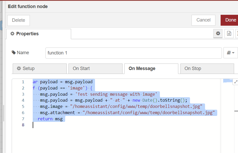

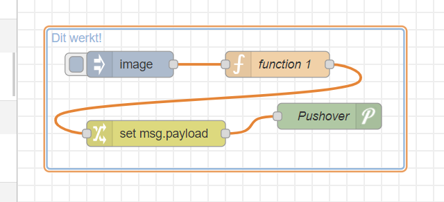

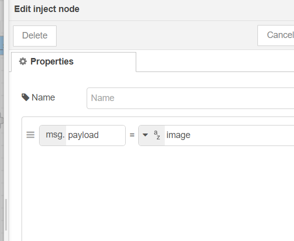

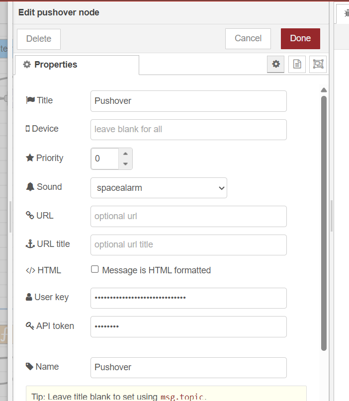

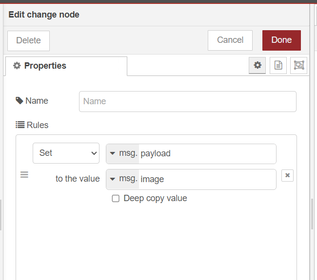

So first i set it up very basic with a inject node (just to manually trigger it and see what i get to work).
I placed a jpg file in the root just for testing things out. Below the images what i created. When i trigger the flow i got that manual image that i uploaded with a text on my phone:
