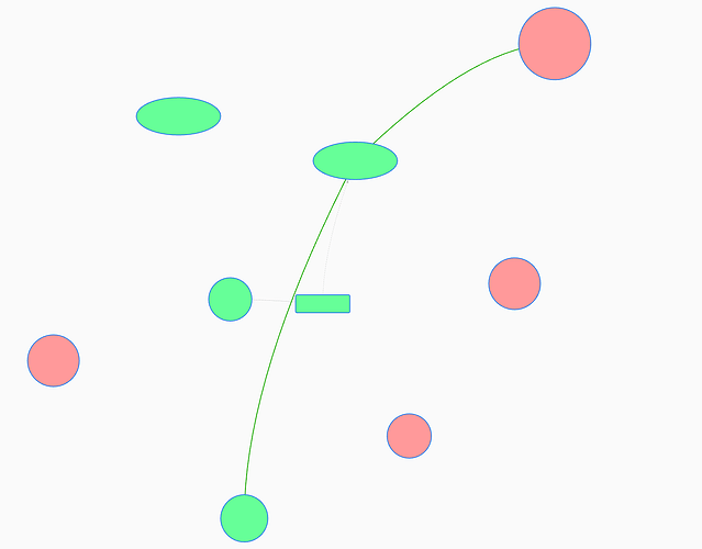

However, i have a couple of Aqara single buttons that just wont work properly. They show up in ZHA, but wont execute any actions at all. One of the Ikea plus is within 2 ft and it still wont execute any actions.
Here is an image of network. The buttons are the circles in Red. Is there anything special I need to do for everything to be working appropriately?

Aqara devices are notoriously resistent to using better routes if one becomes available.
What usually works is to pair/add the Aqara device again, without deleting it first (although I’ve only used this method on Zigbee2MQTT, I don’t know if it’s possible with ZHA), from the location you intend to use it.
Basically put ZHA into “allow join” mode, then put the Aqara device in pairing mode, and wait.
