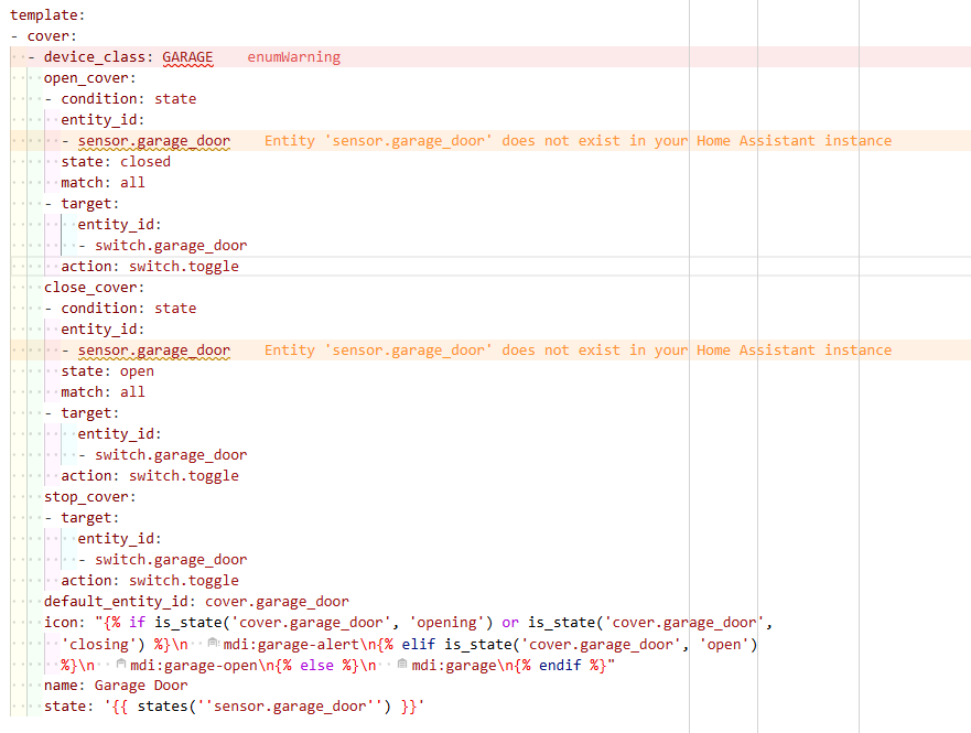

new template that was pre generated:
template:
- cover:
  - device_class: GARAGE
    open_cover:
    - condition: state
      entity_id:
      - sensor.garage_door
      state: closed
      match: all
    - target:
        entity_id:
        - switch.garage_door
      action: switch.toggle
    close_cover:
    - condition: state
      entity_id:
      state: open
      match: all
    - target:
        entity_id:
    stop_cover:
    - target:
        entity_id:
    default_entity_id: cover.garage_door
    icon: "{% if is_state('cover.garage_door', 'opening') or is_state('cover.garage_door',
      'closing') %}\n  mdi:garage-alert\n{% elif is_state('cover.garage_door', 'open')
      %}\n  mdi:garage-open\n{% else %}\n  mdi:garage\n{% endif %}"
    state: '{{ states(''sensor.garage_door'') }}'

You have kept that part, right?
The deprecation notice you got was only regarding the cover: part.
Also, device_class are lowercase (“garage”).
The all caps “GARAGE” caught my attention! But, being new to templates, I wasn’t sure that it was an issue…so I didn’t feel “qualified” to point it out. Still learning :slightly_smiling_face:
Edited: I think I remember reading about ‘device_class’ all caps in the 800+ posts Deprecation thread…
I have kept all that part and changed garage to all lower case as I seen it said there was an issue with it being in all caps
