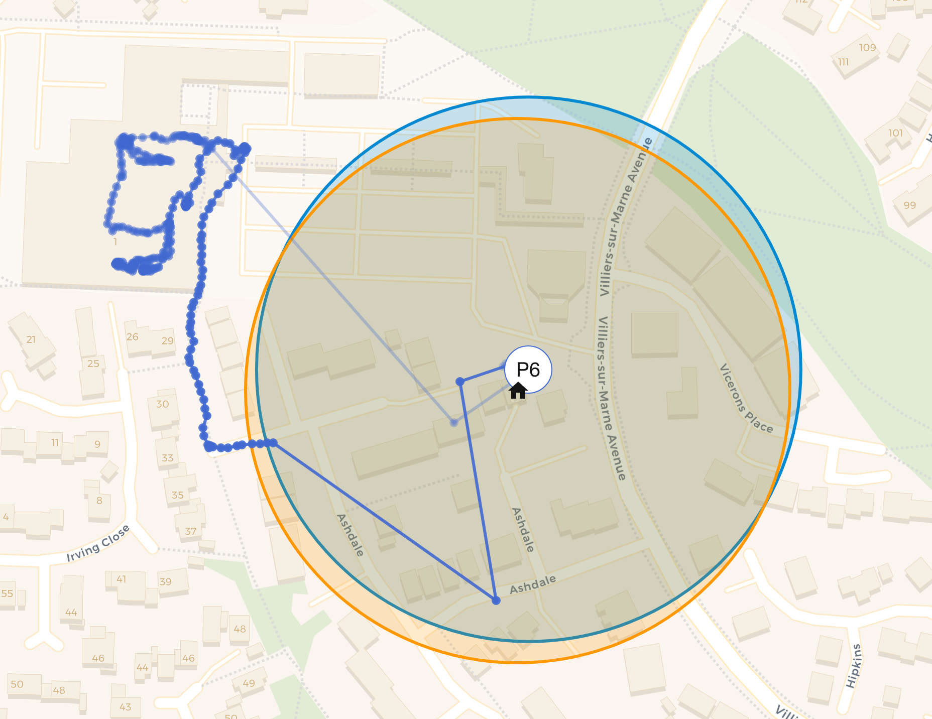

It seems like the high-accuracy zone is backwards?
On the map shown, the right-hand route trace is where I went out yesterday - the outer orange ring is my higher accuracy zone, none.home is the blue middle ring. The increase in data logs seems to to show the accuracy increasing after leaving the zone??
The left-hand trace is my return home and shows no accuracy at all, not even near the road i was on as data points were so far apart.

This looks better, I went for a stroll yesterday - i live next to a supermarket. It looks like the extended zone for accuracy mode works well as I can see my phone was pinging location all the time I was out. Not the best for battery but I guess I can't have everything and as the store is well within the extension it is doing it's job hopefully.
