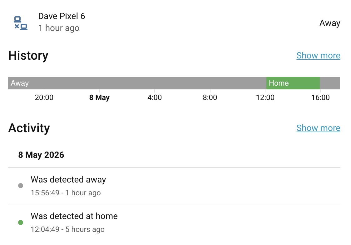

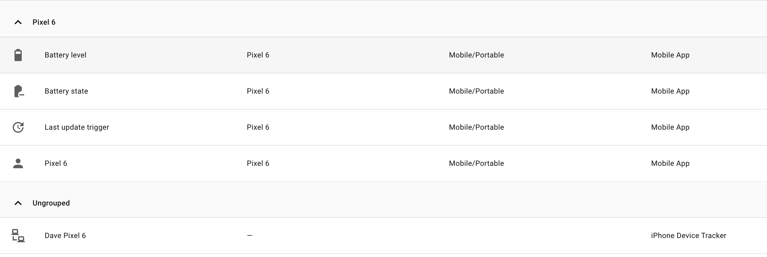

Looking at my entities, on my laptop at home i get the result in the picture below for my phone entity
The history is odd, the "Pixel 6" entry shows it at home 100% of the time whereas the "Dave Pixel 6" entry shows me coming and going as expected (work etc)
Is there a reason for this?

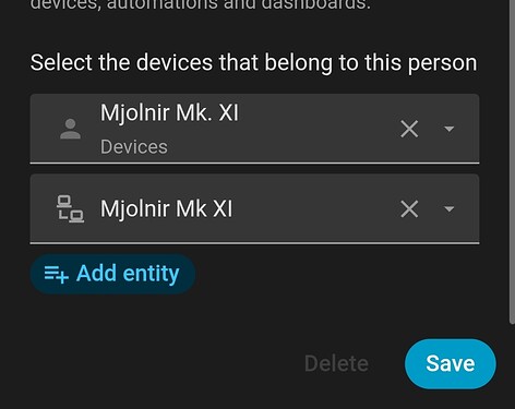

Which device trackers have you assigned to your person.
If you do not have external access through Nabu or other, the minute that device drops off your net it's unable to contact to even say not_home so your companion tracker will fall out when it times out.
Your ip tracker based on the net will light when you're connected to that device on the net.
YOUR state depends entirely which trackers you have marked to your user.
These are the trackers I use. A unifi entity marking the Mac and a device tracker on my HA companion

I have assigned "Dave Pixel 6" to my person - its the IP tracker integration.

Until you get your external access sorted, it will probably be best to remove the Mobile App tracker from your person. Also, in the settings for your person, check if "Allow login" is enabled. If it is, any device with a tracker that is logged into with the username attached to that person will be used to determine the location of that person entity.

The picture above was showing my IP tracker not the GPS/App tracker so it would never show anything other than home or away, the GPS one does show me at the location I am now which is pretty impressive to me at least.
Glad to support HA, been a long-time user now it's time to give-back I think.
It would. But not under the history of "Dave Pixel 6" which is HA detecting whether you are on home network, but the (other) history of "Pixel 6", which is your phone reporting where you back to HA.
And if you put both your "Dave Pixel 6" and "Pixel 6" under the yourself as the Person, as Nathan suggested, then you can see the location of this Person moving in and out of the zones.
