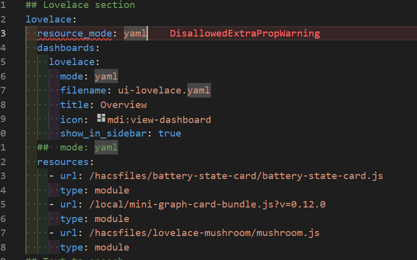

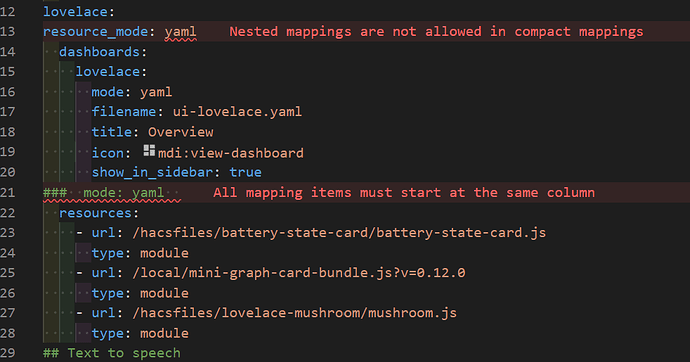

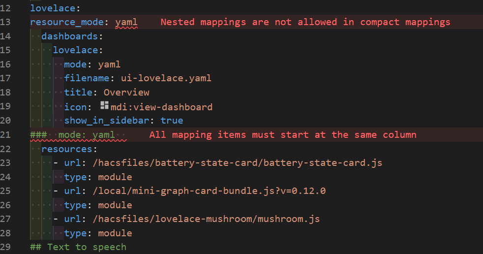

I’m in a similar boat: I can’t restart like this.
So with some spacing I got it to get restarted, however…
And My overview dashboard is -gone-. Just says New Space. It did this after the update, so not new. What do I need to fix?
Chris is correct, you don’t touch them. I e do nothing with the resources, leave them as is
After you make the change to a configured yaml dashboard, you go in the ui and set it as the default dashboard
