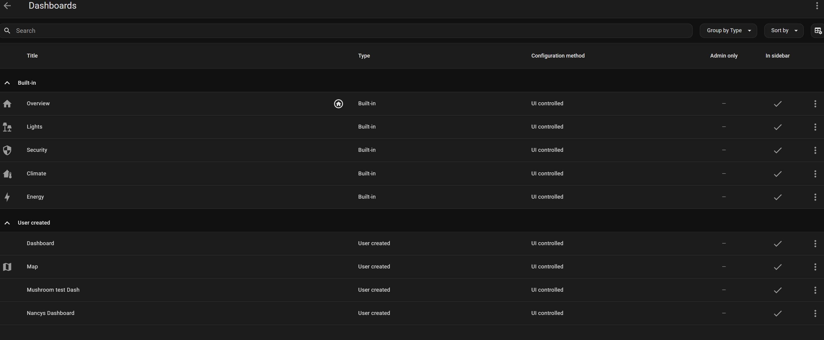

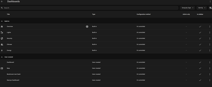

if you used mode: yaml before, you were using a file named ui-lovelace.yaml to configure your dashboard. That file still exists and has not been altered.
If you want to continue to use that dashboard, you need to add the yaml to make it appear in the dashboard list in your 2nd image. From there, you can set that dashboard as the default dashboard. Just keep in mind that the URL you used in the past will no longer be the same, it will now have a new URL. You’ll need to close browsers (or click the dashboard on the sidebar) and refresh your bookmarks in whatever browser you’re using.

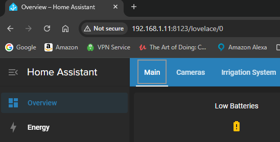

the URL for my original dashboard is exactly the same as it was before as “http://192.168.1.11:8123/lovelace/0”. I verified it by logging in in an incognito window as well.
the new overview dashboard is “http://192.168.1.11:8123/home/overview”.
I didn’t need to change any bookmarks/references anywhere.
Your new url is going to be set however you set up your new yaml dashboard. E.g. I used this:
  ui-home:
    mode: yaml
    title: Home
    icon: mdi:home
    show_in_sidebar: true
    filename: ui-home.yaml
so my url is ui-home/home puilled from the slug ui-home and the title home.
No matter how you use it, the lovelace/0 url is what is deprecated and will not work. It should always redirect to the new auto generated dashboard.

the lovelace/0 url is exactly what is shown on my incognito window and works navigating to and from.

Go to 192.168.1.11:8123 without filling out the rest of the url in a new browser and log in and it should redirect you to your default dashboard url which should be lovelace/overview based on your config.
sidebar: You could be running into these odditites because your dashboard is labeled lovelace:. I did not go that route because the repair during beta was completely different.
Nope. I just did it.
opened a new incognito window, typed “192.168.1.11:8123” with nothing else after it and redirected straight to the above URL in the screenshot.
Interesting. I’d wager there’s an issue then with using the lovelace slug. The lovelace\0 url for me (not using any lovelace slugs) always redirects to the new autogenerated home dashboard, not my default dashboard. Regardless how I log in, HA always redirects me to ui-home/home
Oh I think I see it.
As referenced in the docs to get the exact same functionality as before you do have to create a dashboard called “lovelace:”. Yours is using a different dashboard (ui-home instead of lovelace) but directing to use the same old “ui-lovelace.yaml” as the file. So your dashboard URL is probably different due to that change.
Yeah, because during beta none of that stuff was found yet. So I updated my dash before they fixed things and now I just live with the change. They must have added the lovelace/0 back as a url redirect. It didn’t exist early betas. Good to know though.
