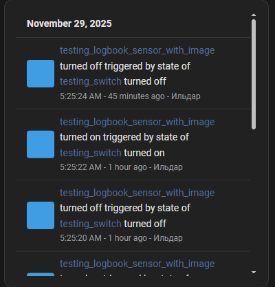

In general, a history of changes of some entity which has an “entity_picture” dynamically defined (like that “camera” entity) is possible with a custom logbook-card:
    type: custom:logbook-card
    entity: binary_sensor.testing_logbook_sensor_with_image
    history: 1   # in days
Here you can see a list of states (“on/off”) with an “entity_picture” (instead of an icon) since this entity (“binary_sensor.testing_logbook_sensor_with_image”) has an “entity_picture” defined - and it is dynamically changing (mimicing some camera/media_player/etc entity) dependently on a state (“on” = orange picture, “off” - blue picture).

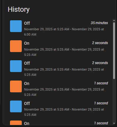

Note that a stock logbook card will not show proper "entity_picture"s, only the CURRENT one:
although info about “entity_picture” is available in DB for EVERY change.
Consider this as a strange limitation of the stock logbook card.
So, using the custom logbook-card will help.
