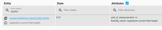

This returns the next tide height data point using an ugly command_line sensor and a lot of black magic:
- platform: command_line
  name: Appledore current tide height
  scan_interval: 1200
  unique_id: 6eb949ed-52ab-49fa-827e-90c45ec488ee
  command: "curl -s https://tides.willyweather.co.uk/sw/devon/appledore-torridge.html | grep forecastGraphs | cut -d: -f2-"
  unit_of_measurement: 'm'
  value_template: >-
    {% set input = value[:-3] %}
    {% set points = (input|from_json)['forecastGraphs']['tides']['dataConfig']['series']['groups'][0]['points'] %}
    {% set n = now()|as_timestamp()|int %}
    {{ (points|selectattr('x','>=',n)|first)['y'] }}
The points data structure has a load of entries with x as the Unix timestamp and y as the height. Play with this in the template editor — the first two lines do the same job as the template above but with hardcoded data rather than the lookup:

Replying to myself: my previous attempt above doesn’t look through all the data. There are several groups of points in the data to allow for the graph plotter to insert moon phases, and I was only looking at the first (['groups'][0]['points'] in the second line of the template).
Probably won’t make any difference for the “next tide height” sensor, but good in case you try to create other look-aheads — this one looks through all the groups:
  scan_interval: 1200
  unique_id: b933ef4d-4b36-4e45-afdb-619eee1bb02e
  value_template: >-
    {% set groups = (input|from_json)['forecastGraphs']['tides']['dataConfig']['series']['groups'] %}
    {% set ns = namespace(points=[]) %}
    {% for group in groups %}
      {% set ns.points = ns.points + group['points'] %}
    {% endfor %}
    {{ (ns.points|selectattr('x','>=',n)|first)['y'] }}
