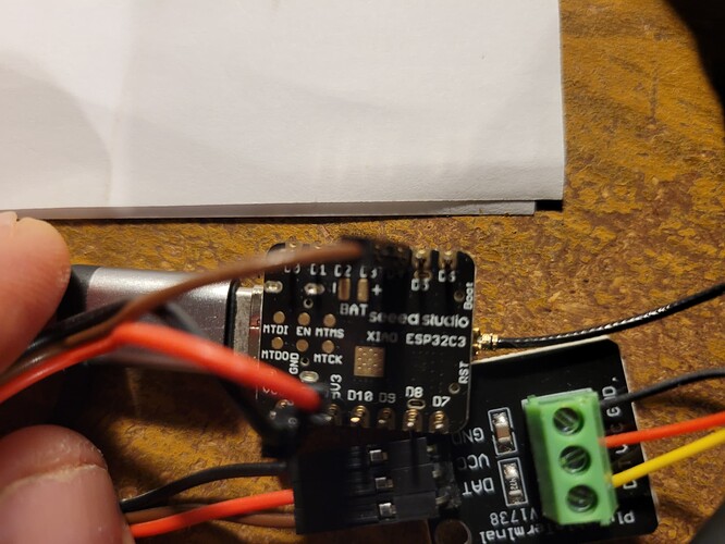

Help with my first ESP32C3 with a Dallas DS18B20 sensor
I’m new to ESP Home and I’ve managed to get my ESP32C3 recognized, but not the temperature sensor.
It’s a cable with a DS18B20.
I’ve wired:

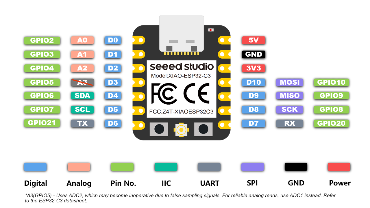

GND → GND
VCC → 3.3V
DAT → D5 #ERROR I PUT IT in D4
The device is not found
[20:41:56.795][C][gpio.one_wire:152]:   Pin: GPIO4
[20:41:56.795][W][gpio.one_wire:083]:   Found no devices!
Can you tell me what I’m doing wrong?
Thank you very much !

Xiao C3?
D5 is gpio7
Yes Xiao C3
I use D4
Thank you I understand and found this
I will try soon
D4 is gpio6. But you wrote D5 on original post.
In both cases it’s not 4.
Thank you again.
I put it on D4 and change the code.

Bad soldering?
Yes ! Thank you
