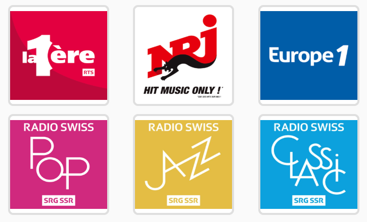

I have a NAD amplifier with a BluOS component and that lets me preset (in that context) internet radio broadcasts as preset 1, preset 2, …
My goal is to present a dynamic list of those presets in HA so that I can tap an image and get the amplifier tune in to that preset.

Those 6 shell commands are manually configured as the tap_action of 6 custom:button-card:
Goal is to get those buttons dynamically
