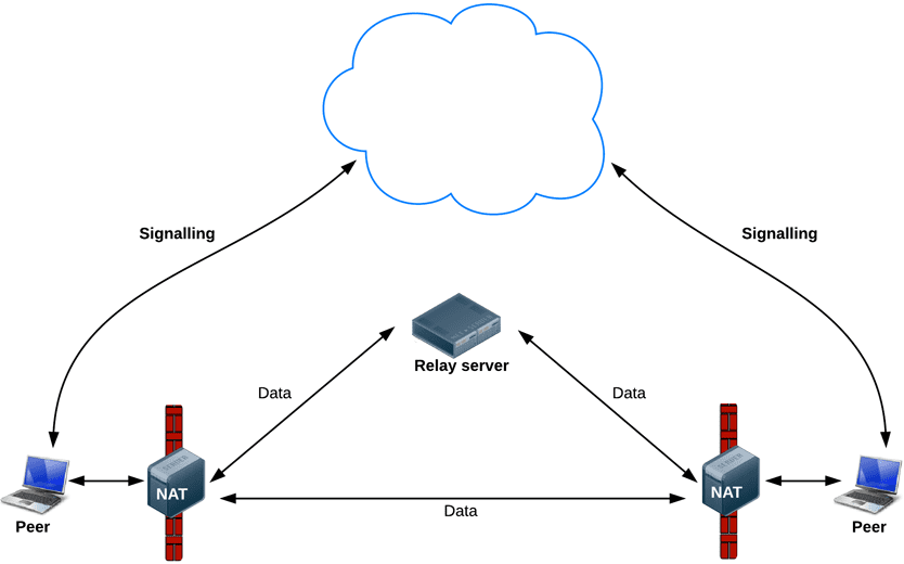

Help with reverse engineering WebRTC with VicoHome Camera
I’ve managed to intercept most of the TLS communications after patching the app with reflutter to disable flutter’s SSL pinning. I’ve also managed to create a script to request a new username and password to access the TURN servers. So far my understanding is that ICE makes it easier to access the stream by having the client (KVS WebRTC) access relays if a direct connection to the webcam is unavailable:
I’m using this example to build a WebRTC client that is able to use ICE with TURN to (hopefully) access the stream and somehow get it into Frigate:
simple_webrtc_python_client/examples/webcam at main · aljanabim/simple_webrtc_python_client · GitHub.
Because this uses KVS WebRTC (which is what AWS Kinetic uses) I thought maybe I could get go2rtc to work since it supports Kinetic streams but so far I haven’t had any luck going that route.

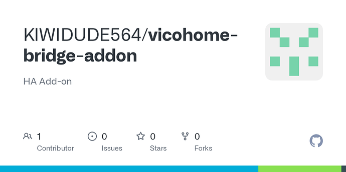

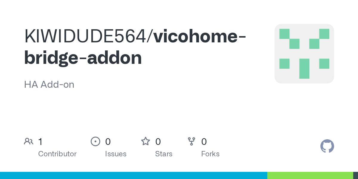

I hacked together an unofficial Home Assistant add-on that brings Vicohome cameras into HA using vico-cli and MQTT.
Repo (with full README, install steps, dashboard YAML, and troubleshooting) is here:
The add-on:

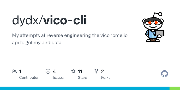

• Uses vico-cli (all the heavy lifting is done there):
• Logs into Vicohome (I recommend a separate “bridge” account that your main account shares cameras to)
• Polls for events and device info
• Publishes everything to MQTT and uses MQTT Discovery so HA auto-creates entities
Per camera you get:
• Last event sensor (with attributes like timestamp, imageUrl, videoUrl, eventType, serialNumber, etc.)
• Motion binary sensor
• Battery %, WiFi signal, and online/offline sensors
Everything else (detailed install, config, MQTT notes, optional Lovelace dashboard, and troubleshooting) is in the README in the repo.

Is your supabase edge function using different API endpoints/params then vico-cli?
I’m unable to list events via vico-cli but can see them through your hosted app (vicoweb).
