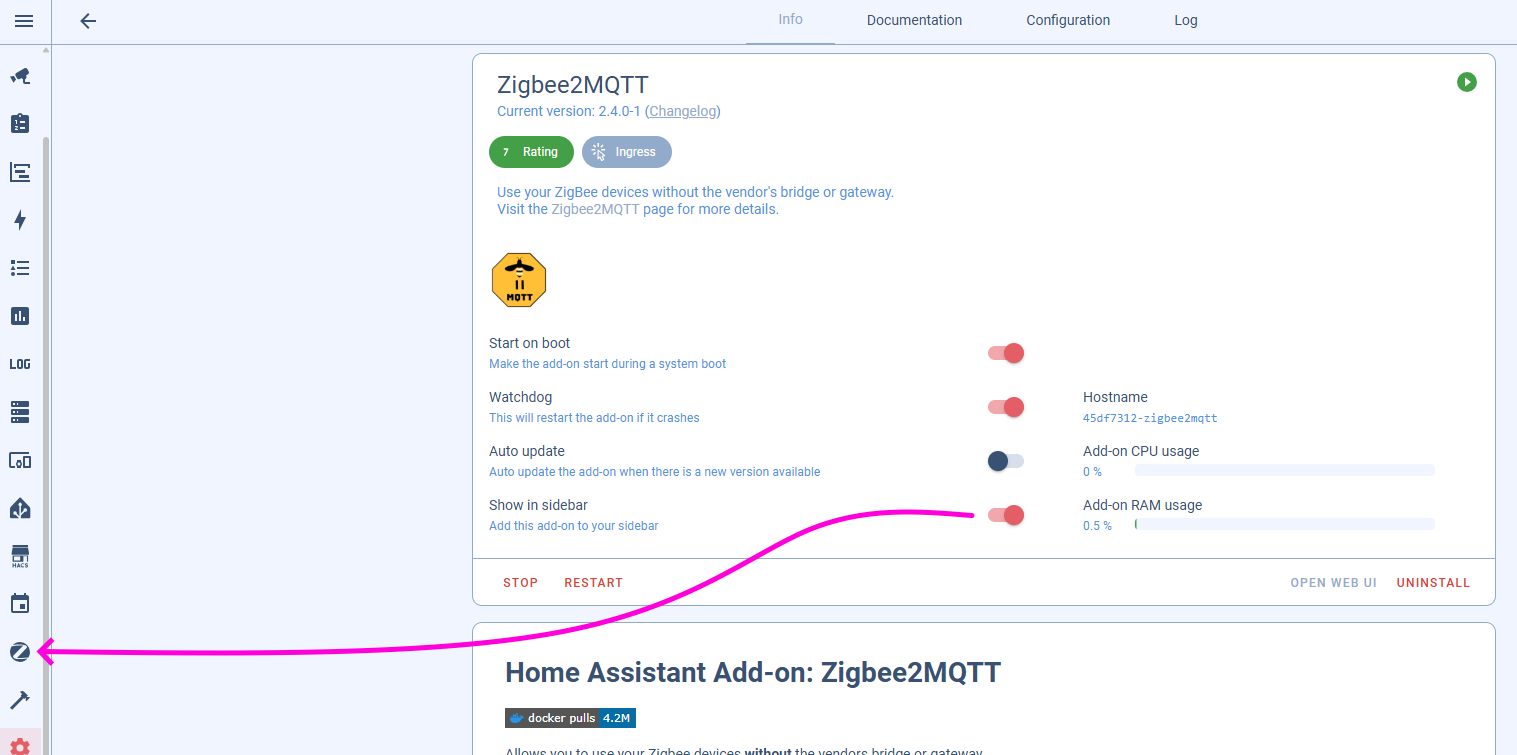

Check that both Home Assistant and Z2M are fully up to date. Then doing this should work:

Ah, ok your are not running HA OS. So you have containerised Z2M, not the HA add-on. I don’t know a whole lot about that. Someone else will have to help. As far as I am aware Portainer is only an issue for HA OS, you should be fine to use it.

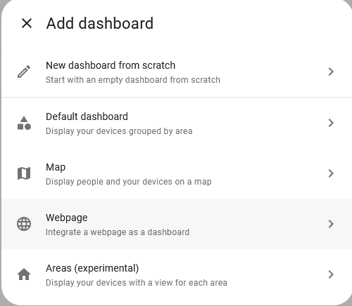

Add dashboard → Webpage, enter your Zigbee2MQTT url
