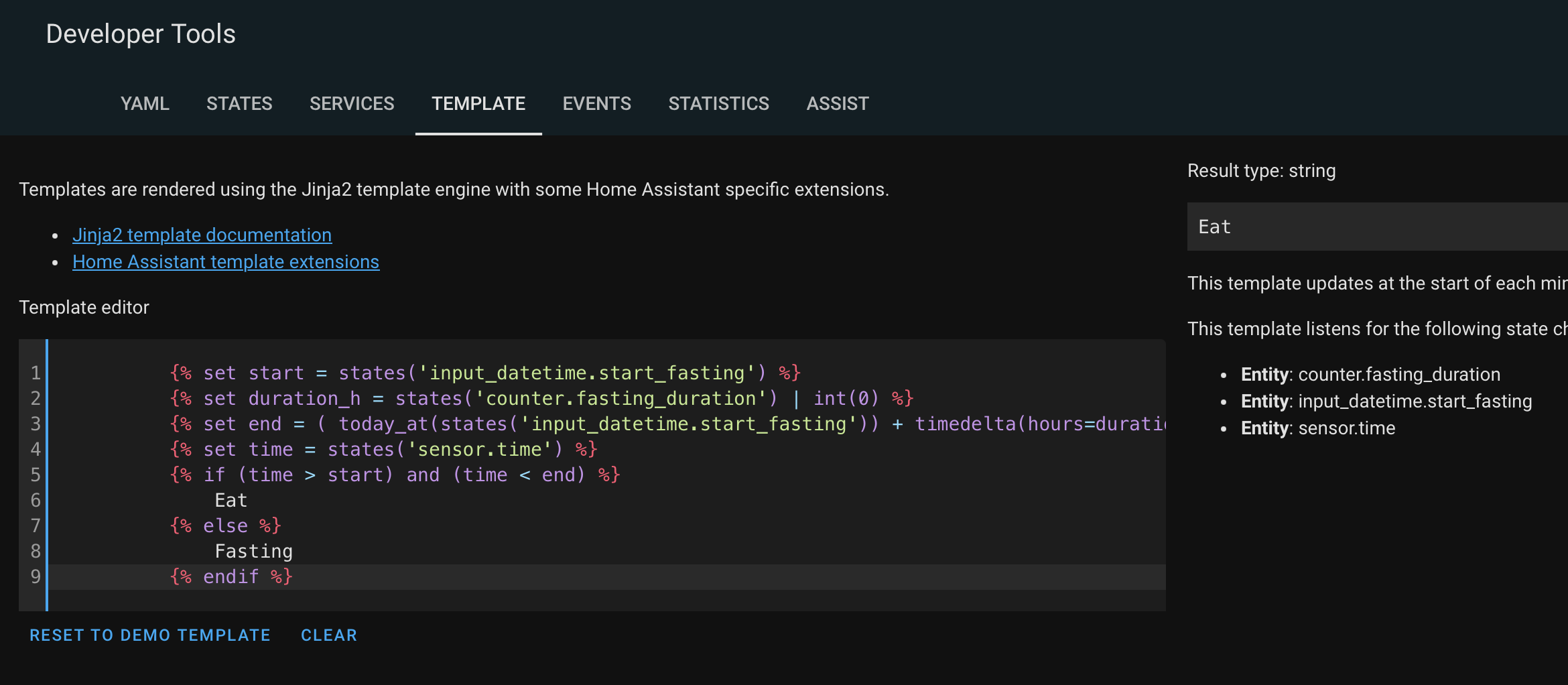

Hey thanks for your help, that appears to have fixed it, I have really bizarre issue though, Ive developed the code in development tools which is now showing the correct status of “Eat” as it is within the window, however when I view the entity it gives me a different result, any ideas what im doing wrong here:

Very odd the history seems to report the correct value, but the state doesn’t.
