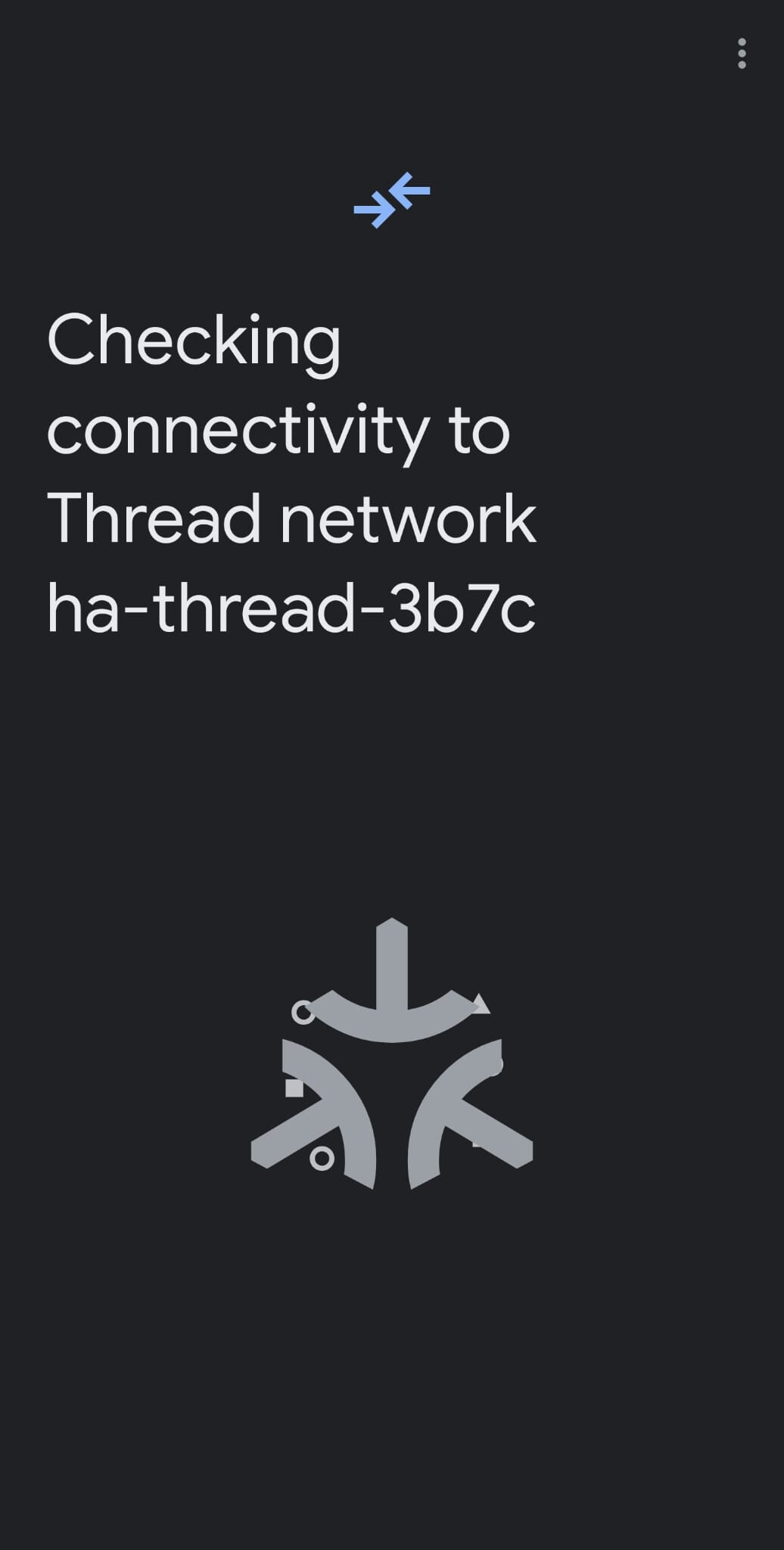

Then I went to add new matter device, scan the QR, and it says connecting to device few seconds, then generating matter credentials, then checking connectivity to thread network ha-thread-3b7 few seconds and then can’t connect to thread network.

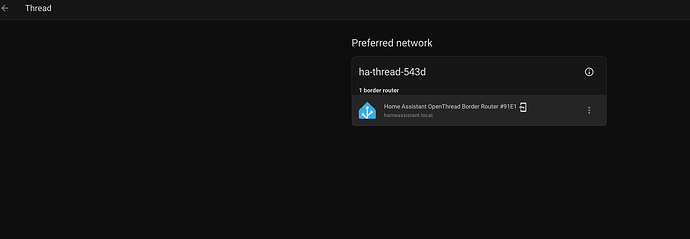

One thing I don’t understand. So in the settings the network is called ha-thread-543d, but in the companion app when I scan it’s trying to connect to ha-thread-3b7c. I remove the services, I reset the server on companion app i reset the cache, I sync the thread credentials again, every time it’s trying ha-thread-3b7c

I think the problem has to do with Google services. I tried another to add it to google home and its trying to the same ha-thread-3b7c, i deleted data for google home, and google , still the same.
have a look here
but read the advice concerning deleting all data from Google Play services (I did it myself in the past for other reasons)!
In the end, I managed to add them using an iPhone. I will buy another just so that i try reseting the Google play. I spent all day with the Samsung, it took 10 min from the iphone. :grimacing:

In my case the problem is that is trying to connect to a border router, other than the HA.
Like @jhol-byte said, the proble is Google and not HA. Google cashes thread credentials in the Google play services. The only way to get it to work, is to delete Google play services data ( but you loose the wallet credentials also), use another phone or tablet, or use an iPhone. On IOS, it works without any isses.
