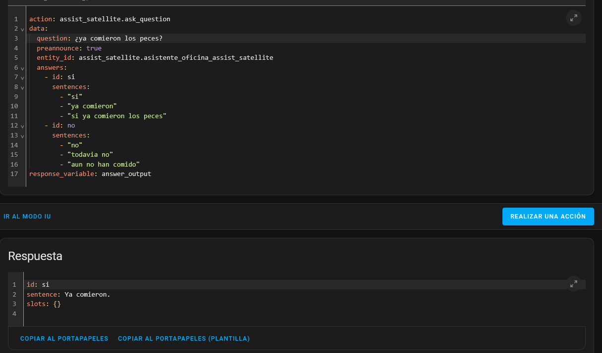

i just test this action and it works
action: assist_satellite.ask_question
  question: ya comieron los peces
  preannounce: true
  entity_id: assist_satellite.asistente_oficina_assist_satellite
  answers:
    - id: si
      sentences:
        - "si"
        - "ya comieron"
        - "si ya comieron los peces"
    - id: no
      sentences:
        - "no"
        - "todavia no"
        - "aun no han comido"
await self.async_start_conversation(announcement)

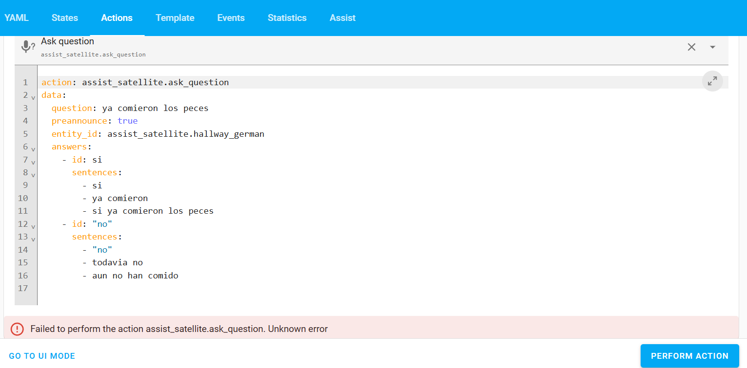

Hi I tired your code, but it dosent work.
It throws the same error, I documented above.
I used the wyoming satellite by cloning the setup and run the setup script.
I havent tested to run this script again. I set up the satellites in January
the error you have in your log is that you satellite don’t support this option
