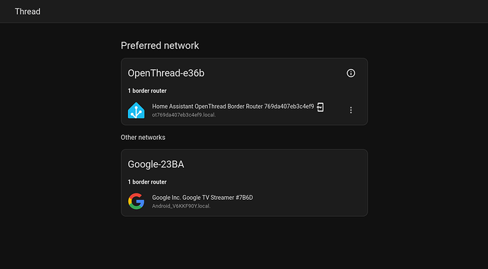

This is what my thread page looks like:
See screenshot link above

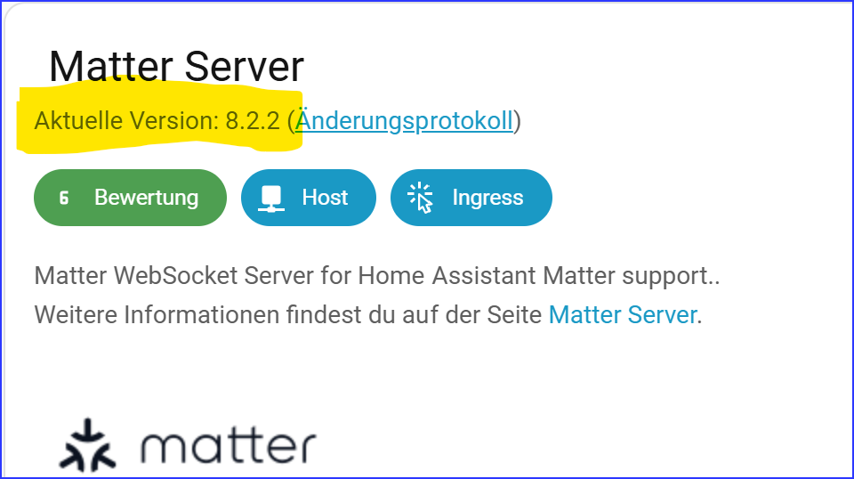

You probably have installed Matter Server 8.2.2. Go to Settings|Apps, open Matter Server and look for a button “Open web interface” (or something like that, launching the MAtter Server GUI)". Click on Thread and you’ll see your Thread mesh.

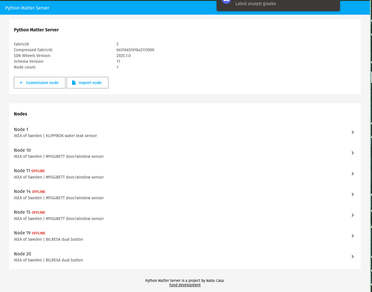

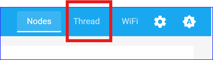

Thanks for the suggestion. When I open that UI I don’t see a Thread button. I can see my devices but I am not sure how to tell what they are connected to.
This is the version that you need to have installed:
If this is the case, open the configuration on the same screen and activate “Use the latest beta version”. Then restart HA and try again.

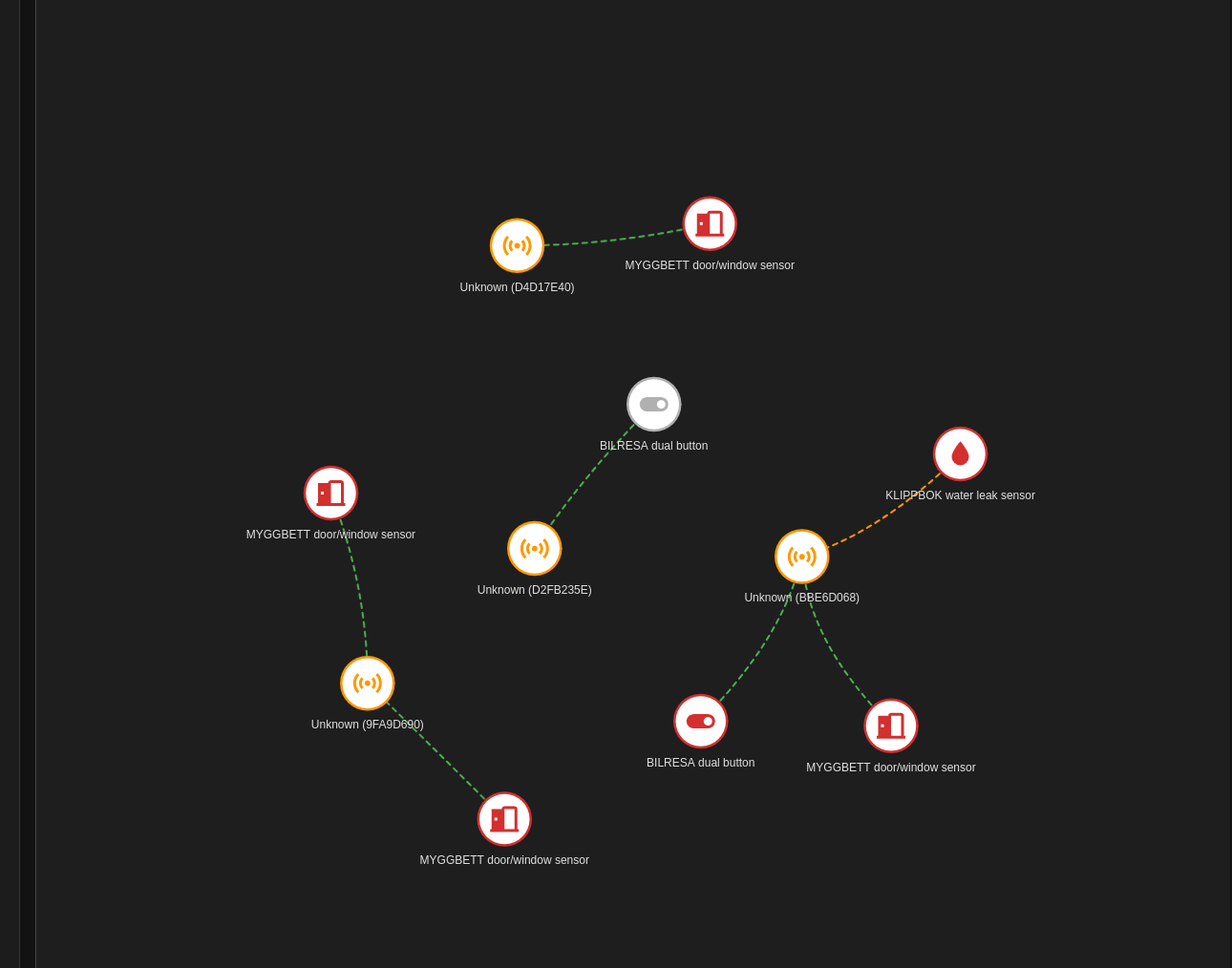

Just figured that out, after enabling the beta version I can now see the network but it doesn’t look right.
Right. You have four border routers that are not connected to each other. YOu seem to have some IKEA Matter stuff, maybe plus hubs. CAn you describe what you have?
In some aspects Thread is still a mystery for me. The issue is that the Thread connectivity is stored within the devices. Contrary to what one would think, your border routers do not form a mesh. Don’t ask me why though.
What you could do is
A) Reboot the machine that HA resides on. Thread runs in a Docker container and is not restarted if you only restart HA. There is the chance that the mesh reorganizes itself, but I doubt that. After reboot wait 1 hour to see if anything changes.
B) Start from scratch (maybe somebody else has a better idea )
  1. Identify which of the above border routers is your HA / ZBT unit.
  2. Unplug all other devices including the border routers, e.g. the IKEA Dirigera…
  3. Reset one of the devices, get it close to the ZBT (or whatever you use) and connect it to your HA OTBR through means of the HA Companion App.
  4. Repeat step 3 for all other devices.
There are three additional units in your mesh that currently act as routers. Ideally you could connect them to your HA like you did in step 3. Once connected you can place them elsewhere, yet one within reach of your main HA unit, etc… Beware, Thread has not the same reach as WiFi and additonal routers could be necessary.

AH, I didn’t really analyze your pictures as they were not in the thread.
The problem is that your phone doesn’t have the HA Thread credentials yet. Open HA on your smartphone, go to Settings | Companion App. Scrool down to Troublehooting and sync teh Thread credentials to HA. Not sure what it is called in English, but you will find it.
Then check OBTR on your HA unit again - there should be that small key behind its name, indicating that credentials have been synchronized.
You should bow be able to connect your IKEA devices to HA (step 3/4 in my explanations).
Like before: reboot the HA unit and then check if the system reorganizes

The view is correct at first sight. This what is happening:

Another caveat for Matter-JS server Beta users looking at the new dashboard thread network graph, the S4, even with the latest Matter 1.4.1 firmware, do not include the optional ThreadNetworkDiagnostics cluster so they will not meaningfully contribute data back to matter server for the new graph. They function well regardless.
