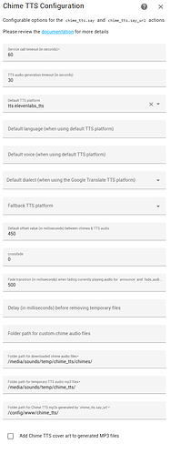

Also, this may be important for the “Tag” search here are the Chime TTS configuration parameters:
