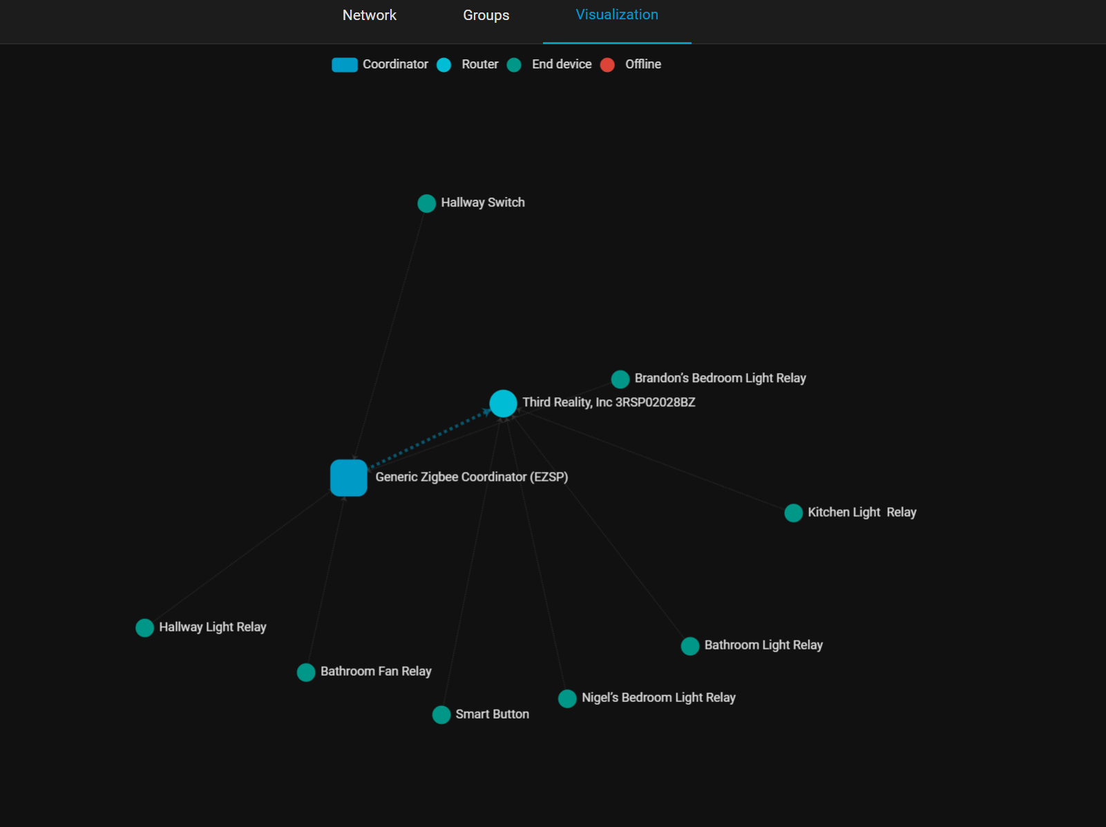

Here are some methods to keep the zigbee mesh healthy so this may be not needed. Several posts in this section could be helpful to you. The Home Assistant Cookbook - Index
Solution For Bad Zigbee Network
I’ll answer your question but firstly consider a zigbee mesh router. They come in a few form factors and are easy to setup. But essentially what they do is repeat the zigbee signal to extended your zigbee network reach and performance. Best to fix your network problems when you get the chance.
the one I’m using is a cheap outlet plug with power metering and oncourse doubles as a zigbee router. you can get a 4pack for $38.
