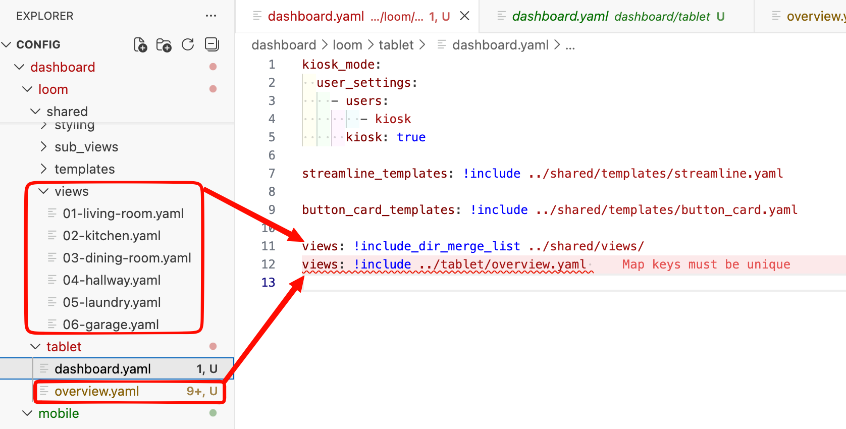

I am trying to create a unfied dashboard that works well in all my devices. All the room cards are the shared between the devices. But I have different home pages for different devices. Now, I am trying to include all the room views in the ‘views’ folder and the ‘overview.yaml’ from the device specific folder. Any suggestions on how to include these two under the views?
You cannot have 2 view keys. You cannot have views spread across 2 separate folders when including because it expects a list.

Then you should just make a different dashboard. Then your views will be unique between dashboards.
The issue is that you’re trying to use a single dashboard. A single dashboard only allows 1 views key.

I mean, there’s ways to get what you want. Just run an include in each of your files that point to an overview.
Thank you for all your suggestions. Figured out a way
views:
  - !include ./overview.yaml
  - !include ../shared/views/alarmo.yaml
  - !include ../shared/views/calendar.yaml
  - !include ../shared/views/camera.yaml
  - !include ../shared/views/climate.yaml
  - !include ../shared/views/f1.yaml
  - !include ../shared/views/lights.yaml
This post helped Splitting a dashboard file into several using include statement or similar - #11 by renespit
