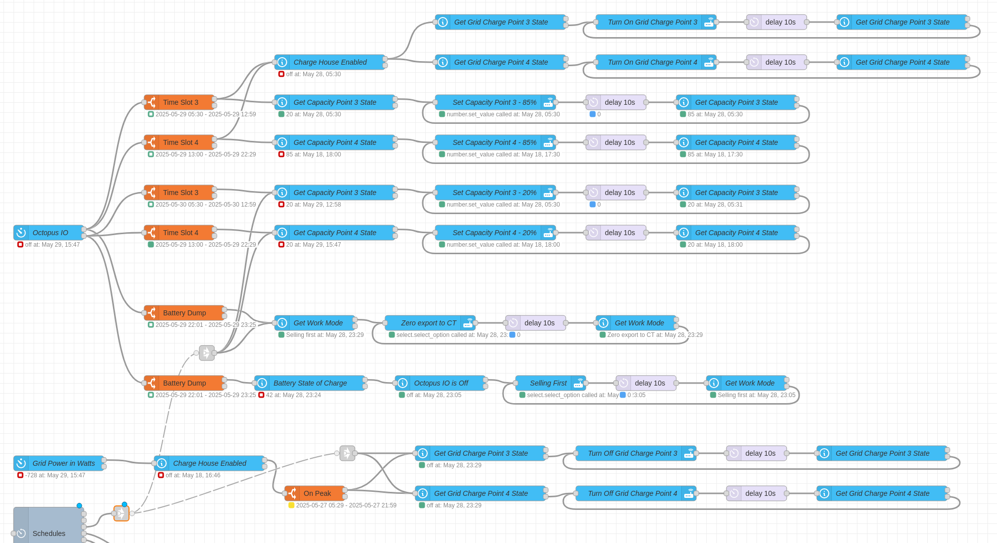

It’s certainly possible as I do it, caveat is that I use node-red with solar-assistant in addition to home-assistant and octopus energy integration.
Solar-assistant requires its own raspberry-pi and rs232 cable, I bought the StarTech DB9 RS232 USB to Serial Adapter Cable from Amazon
MQTT is used between solar-assistant and home-assistant
I can then set the capacity charge point of the inverter depending upon the time and status of IOG intelligent_dispatching. This setup also allows to dump unused battery capacity at 10PM onto the grid thus increasing my export
I can also choose to charge the house batteries along with the car during the day
