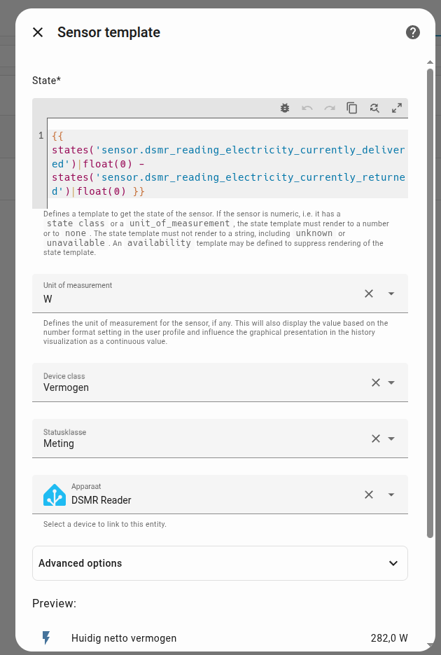

I want to create one entity to display my power consumption or production. I have made one helper with the template sensor with state value: {{ states('sensor.dsmr_reading_electricity_currently_delivered')|float(0) - states('sensor.dsmr_reading_electricity_currently_returned')|float(0) }}
this works fine except, if my production is greater then my consumption it shows a zero instead of a negative value. How/where do I set negative numbers are allowed in the helper?

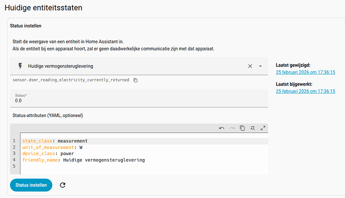

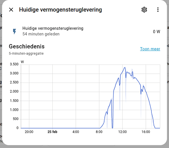

Meanwhile I am learning at the go. I was assuming the float | 0 meant no decimals, but it returns a zero when there is no numeric value. With sensor.dsmr_reading_electricity_currently_delivered I can do calculations, but with sensor.dsmr_reading_electricity_currently_returned I can’t because it always 0 (zero) even if my dashboard shows a value of 3.100 Watts for sensor.dsmr_reading_electricity_currently_returned right now. If this is a string, than the float option should convert it to numeric, right?
All sensor states are strings, and |float(0) will attempt to convert to a number falling back on 0 if it fails.
We’d need to see the actual state of the “currently returned” sensor to be able to diagnose further, but the problem is not in your template. A screenshot from your phone would do:

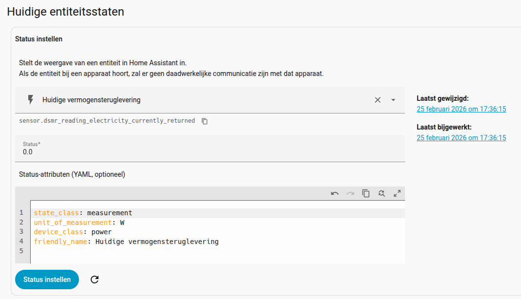

I have made some screenshots to show this sensor.dsmr_reading_electricity_currently_returned sensor report data and also a screenshot from developer tools.
The actual production:
(I can only attach one image at a time)
SOLVED! It’s hard to see, but there was a space between the device name and the last '. Removing the space made the helper work. Thanks to all.
